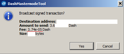

Hi Bertrand.
I would love to have a more readable fee format.
0.0000374 is much better than 3.47e-05
