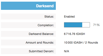

Yesterday it took me few hours to anonymize 400/2....
I started 10K/2 after that and that's what I have less then ~24h after:
Not too bad imo :rolleyes:
