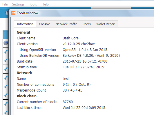

I think the first number on the left is the number of the masternodes that have up-to-date protocol version or the same protocol version with your wallet. Last night after I installed the latest version from Atlassian I saw the number was something like 0/16/16, so I started one MN, the number changed to 1/17/17, Right now my wallet shows:
This version is on protocol number 70093 but when I do "masternodelist protocol" it shows 7 nodes are still on protocol 70092:
EDIT: So as you can see there are 45 masternodes online but only 38 nodes are up-to-date with the protocol version in this scenario.
The other numbers i think are just how many nodes are active, because all 45 nodes show "ENABLED". I think if a node is removed or expired it will show different numbers.
You (almost) got it! :smile:
ds-compatible / enabled (will be payed) / all
There supposed to be a range for enabled protocols but we dropped it for now (or it least it was like that in v25, I haven't got time to read v26 code changes yet :grin:)
EDIT: oh, no, it's back again :grin:
