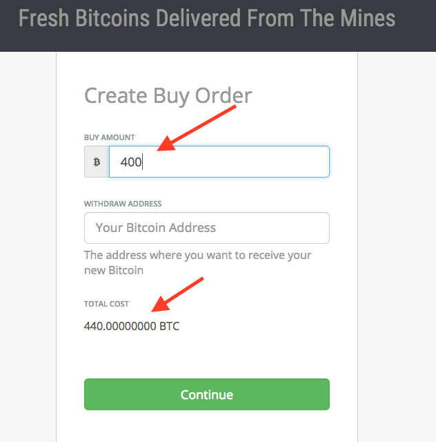

As for the fees - I don't think they are high at all. Compare to this:
https://www.blocktrail.com/mint/#/

:smile: its combined from 2 pics.
:smile:
Talking seriously - works more or less as designed - fees are low but charged more often. That should slightly help to de-incentivize MNs from collecting collaterals for specific miner.
:smile:
