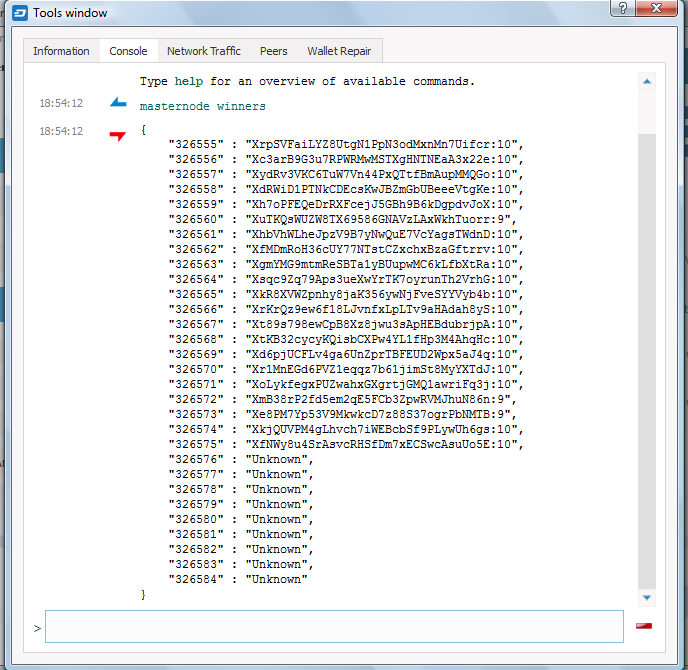

Current masternode winners list:
ugh - MN crashed in last 4 hours
