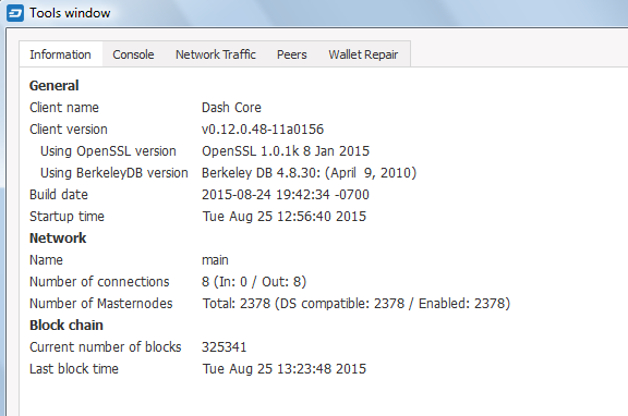

I have just noticed how few masternodes my normal wallet is detecting right now, after masternodes sync its detecting 22 masternodes (total 22 / 16 DS comp / 16 enabled).
I have also tried command 'mnsync reset' but i dont see much improvement... maybe we need some specific command to clear the mncache ? Unless mnsync reset does that ?
v0.12.0.48-11a0156
Here's what's showing on my wallet:
hmm very strange that my wallet isnt detecting all those masternodes, normally after each version update i would delete mncache.dat
but thats impossible now as its integrated.
We don't have mncache.dat anymore, it's been taken out since v.45 or so. Maybe delete peers.dat and debug.log and restart again?

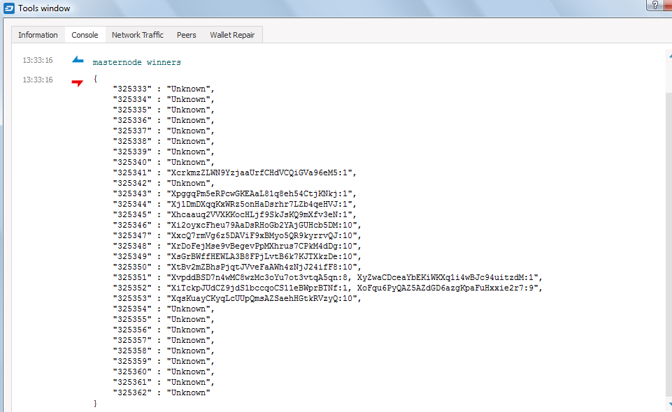

One thing though: the masternode winners list looks kinda strange...
EDIT: Explanation from Evan:
"The unknowns at the top are because of a syncing issue
eduffield[1:40 PM]the consensus issue (which isn't bad at all) is because it's hard to sync with nodes with a memory leak
eduffield[1:40 PM]this should resolve itself in the next 24 hours
eduffield[1:41 PM]the payment algorithm seems to work rather well"
