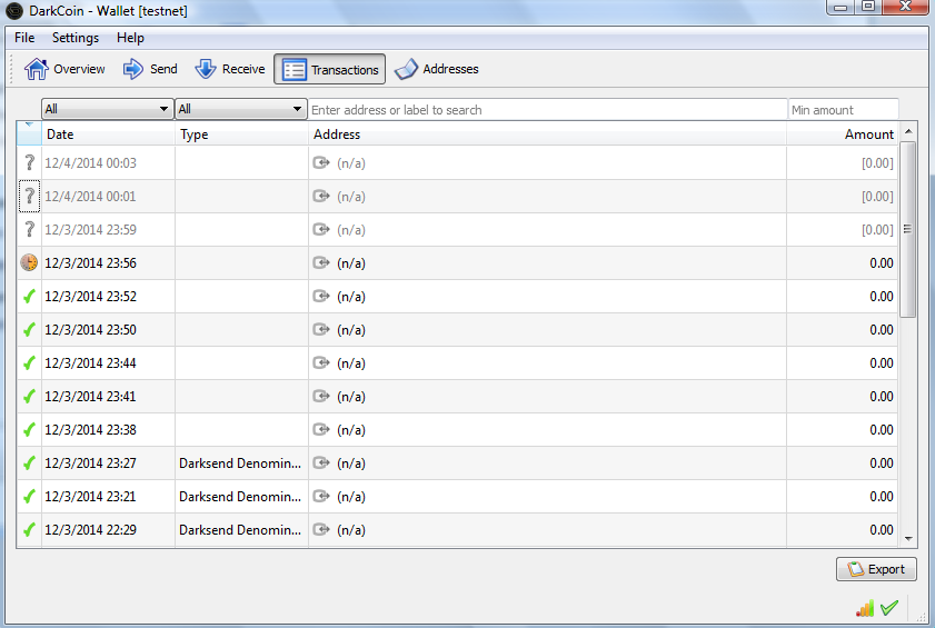

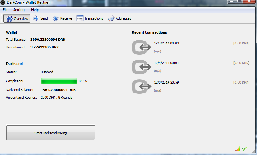

Hmm...Now my wallet has been getting hit with blank type transactions and "Unconfirmed 9.77499906 DRK"
Why do we keep getting these blank transactions? And it seems some of them might be stuck on the block chain again.
Edit: All blank transactions got confirmed.

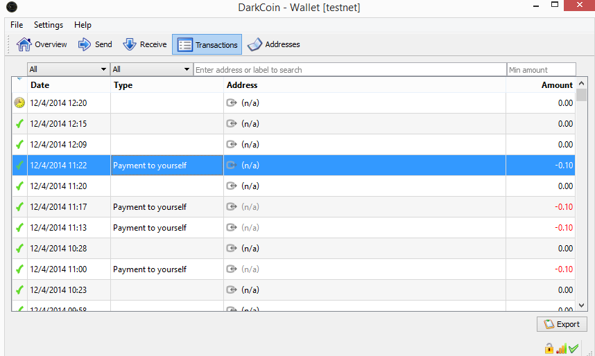

Oops now I'm getting a bunch of blank transactions and collateral charges. Actually it seems darksend mixing should be completed, I have already reached the target rounds and amount, but it keeps on going with these blank TXs and collateral charges.

Also, the denom is 100% but i keep getting ---payment to yourself--- 0.10.
