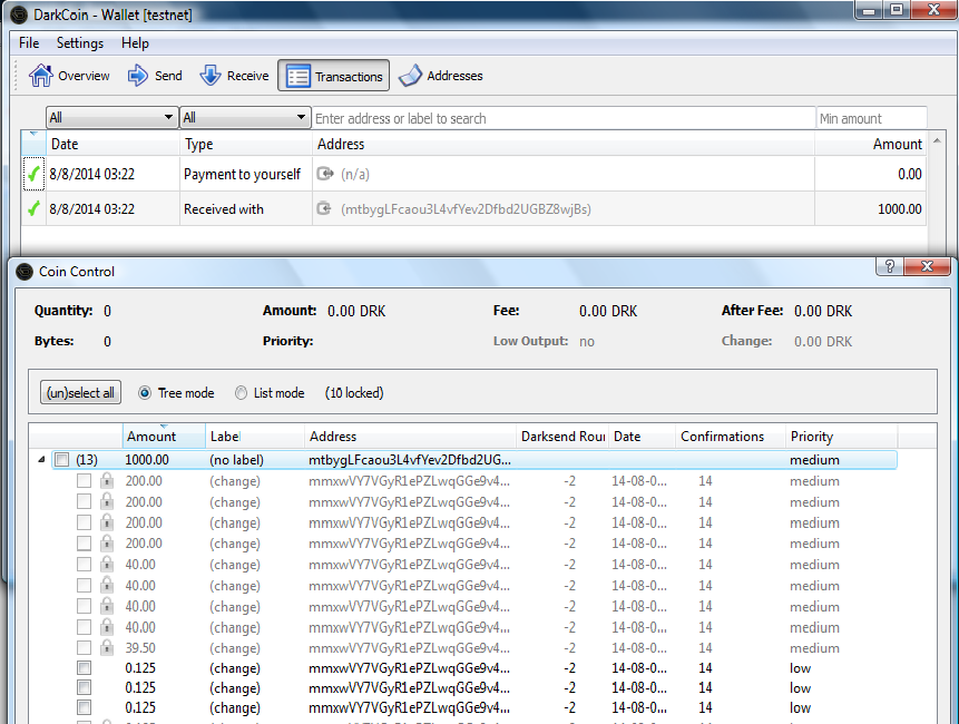

Windows wallet v.17 does not denominate for me. I've tried two fresh wallets but it still would not denominate. And sometimes it sends coins using non-anonymous, sometimes it would not, saying "there's not enough fund in the balance" when there is enough.
Come again?Bug alert!
Updated, and the QT opens with the wallet un
