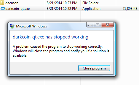

Just installed windows wallet v.10.12.32 and it crashed on the first run. Before installing this version I deleted the old Darkcoin folder with everything in it. I also deleted Darkcoin folder in the registry, just wanted to make a fresh clean version to see how it works. After it crashed, I started it again then it's okay, syncing now. Here's the message for the crash:
Thanks for the report, but the screenshot contains no valueable information at all :) let's blame it on Windows ;-)
I was thinking the same... lol .. I probably need to fix some errors in the system. Thanks, flare.
