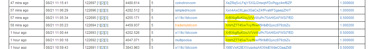

elbereth could you check why 122695 and 122693 are missing in your stats?
When the blocks are too near (below 1min between them), the way I use to retrieve data will skip block templates (it is a cron every minute).
The block page uses blocknotify and should not suffer from the same defect, I have yet to use that method to also grab block templates.

Same issue Blocks:
122457
122455
122373
122371
119963
119965
I went back and looked at the history of my 2 MN and see this pattern often.
Indeed my MNs had the same example.
08/22 15:20:31 123342
08/22 15:17:44 123340
08/22 12:40:33 123276
08/22 12:30:13 123274

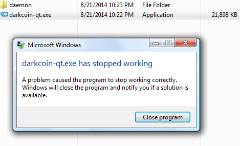

Just installed windows wallet v.10.12.32 and it crashed on the first run. Before installing this version I deleted the old Darkcoin folder with everything in it. I also deleted Darkcoin folder in the registry, just wanted to make a fresh clean version to see how it works. After it crashed, I started it again then it's okay, syncing now. Here's the message for the crash:
