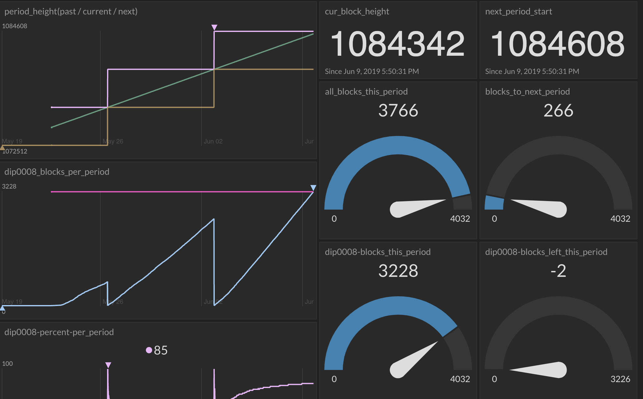

According my calculations only 315 blocks to go before the second window / 4032 blocks has ended and we could have a possible DIP8 lock-in.
Second window should end with block 1,084,608
To check for a possible lock-in : issue a "getblockchaininfo" command
After the lock-in there will be another window of 4032 blocks to activate DIP8
For DIP8 to activate we need 80% of blocks between 1080577 and 1084608 to be signaling support. That's 3226 blocks or more. Block 1084340 was the 3226th block since 1080577 to signal so DIP8 is now guaranteed to be locked in and will active at 1088640. Since is expected to happen (with 90% probability) on 2019-06-17 between 7:05 and 16:32 UTC.
For DIP8 to activate we need 80% of blocks between 1080577 and 1084608 to be signaling support. That's 3226 blocks or more. Block 1084340 was the 3226th block since 1080577 to signal so DIP8 is now guaranteed to be locked in and will active at 1088640. Since is expected to happen (with 90% probability) on 2019-07-17 between 7:05 and 16:32 UTC.
Yup, we have locked in

Edit : strange, thought we still had 10 or 12 hours to go for a lock-in, but according to flare we indeed have already locked in. Dont these windows have an exact number of blocks ? (4032?) :confused:
Technically you are right: The period has 260 blocks left. But as we are beyond the 80% threshold already we are past point of no return and i consider it as locked in :)
