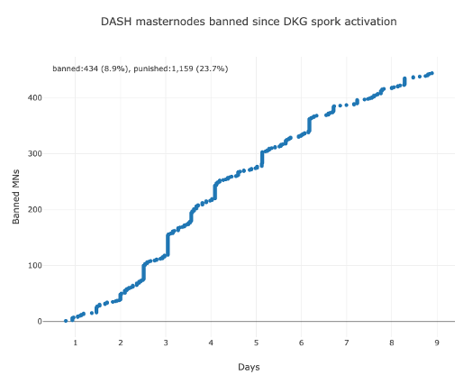

Latest stats (from parsing debug.log):
- unique masternode IDs punished: 1,159 (23.7%)
- unique masternode IDs banned: 434 (8.9%)
This chart is available at: http://sporked.seeger.net and is updated every 10 minutes.

I'm confused, how can we have 434 PoSe banned masternodes according to your info, when the number of active masternodes only dropped by some 200 masternodes?
Link : http://178.254.23.111/~pub/masternode_count.png
Also of the current 4715 active masternodes, only 128 masternodes have a PoSe Penalty score.
Link : https://www.dashninja.pl/deterministic-masternodes.html
Which should make total number of masternodes that has / had a PoSe Penalty score a lot less, then your mentioned 1,159
(below 400 seems more likely). Its almost like your are counting number of punishments instead of number of masternodes here.
Your info is also in stark contrast to latest Dash News article, which only further consolidate my confusion with your info :
We are looking at different stats. Maybe you can help me rectify them as I don't want to spread misinformation. The data I am gathering is based on the debug.log from one of my masternodes that has been running since well before the spork activation.
Everytime a masternode is punished we see an entry like this:
2019-06-13 08:40:50 CDeterministicMNList: PoSePunish -- punished MN cfb62e8bcd113017553d4d69c0f033fe57eca40e5dd5d6b77f336df8b2377da5, penalty 0->3257 (max=4936)
If you count those up (e.g. $ grep "PoSePunish" ~/.dashcore/debug.log | wc -l) you get: 1,755
But, I only want to count the number of unique masternodes punished, not the total number of punishments, so I have a python script to de-dupe based on masternode ID, and the unique count is: 1,178
Everytime a masternode is banned we see an entry like this:
2019-06-13 08:06:38 CDeterministicMNList: PoSePunish -- banned MN 1729b477c347852397a21f17e2df9b6a032998ec50a7b85f9892ebf7599028f1 at height 1086358
Again, a raw count gives: 452, but the unique count is actually: 442. The difference can potentially be explained by the number of masternodes revived because some of them may have been banned multiple times.
$ grep -i revive ~/.dashcore/debug.log | wc -l
159
Why do you think our information differs? I trust the debug.log more that the links you provided only because I'm looking directly at the debug.log and I'm not sure how those other sites are doing their calculations, but there is perhaps an error in my analysis. The number of active masternodes does seem to match the chart you provided:
rseeger@uatu:~$ dash-cli masternode list addr | wc -l
4715
-2 = 4713 (don't count the curly brace lines in the JSON output)
Since I'm counting cumulative bans, the line is monotonic increasing which may be a little deceptive. But, the curve is tapering which is a good sign (once it's flat, no more bans are occurring). Interested to hear your feedback.

I'm quite sure the delta comes from the # of revived nodes.

Maybe someone else can explain the differences in stats, but to be honest i put more value at what i saw at dashninja combined with the number of active masternodes graph, then whats getting
extracted and concluded right now from your debug.log
The difference in number of punished masternodes (350 versus 1100) and the difference in number of banned masternodes (5% versus 8,9%), just seems a bit too large a difference for me currently to solely rely on your debug.log data
(normally i'm in favor of getting raw data through cli commands and using that, but in this case i'm not all that sure the data extraction has been performed correctly)
It could also be that we are looking at two completely different set of measurements, that cant be easily converged into one outcome.

Also, based on what I see, one of the discrepancies comes from the fact that dashninja does not appear to show nodes with a score higher than <something>. I think it may be excluding nodes that are banned. Right now there are 335 nodes with a score > 0, but dashninja only shows ~120 with the highest score being 4105.
$ dash-cli protx list registered true | jq '.[] | select(.state.PoSePenalty>0)' | grep -i "PosePenalty" | wc -l
335
$ dash-cli protx list registered true | jq '.[] | select(.state.PoSePenalty>4105)' | grep -i "PosePenalty" | wc -l
215
