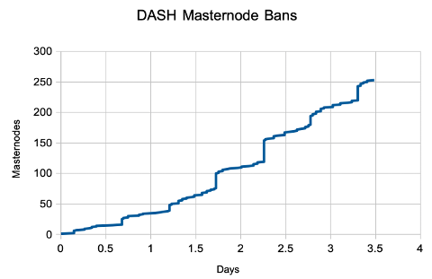

Half my nodes on Vultr are banned even though they've never experienced any down time. All of them have a PoSe penalty > 0. I parsed the debug.log to produce this chart - definitely linear, possibly exponential. I don't think it's worth the effort to re-establish my nodes until this is resolved. There's clearly a major problem here.View attachment 9543

Since activation:
274 total bans
63 revived
2 of the revived were re-banned
Cumulative bans confirmed linear:
Correlation coeff: 0.9866
Slope: 80.48 masternodes bans / day
