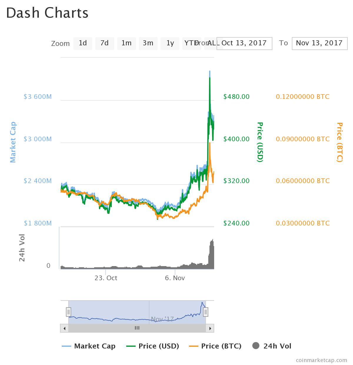

And you can clearly see in the below chart how the market reacted, after the 12.2 update.
Maybe the stupid Masternodes should write for punishment the above sentence not only 100 times, but 1000 times, in order to finally understand it.
And especially for @Macrochip (who rated the above truth as troll) he should write it 10000 times.
