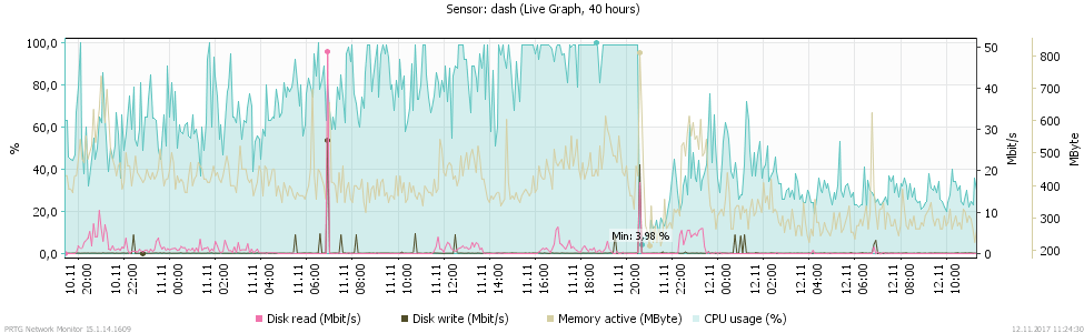

Server specs please?Much better now
Don't remember exactly and don't have access right now, but it's ESXi with something like i7 4770.Server specs please?
Ok, but its more powerful than my 1 x 2.4 Ghz core and 1 Gb ram nodes.Don't remember exactly and don't have access right now, but it's ESXi with something like i7 4770.
For Dash VM - 1 core and 1Gb RAM.

Yes, i also have 25 years experience in the computer field + building and overclocking.I would advice you to upgrade to at least a dual core server, I know it cost a bit more, but it's allot cheaper than missing a payment. At any-rate running 100% CPU power especially on a single core CPU, will most-likely result in your system failing one way or the other. In fact CPU usage around 70%, is much better upper limit to have. I only speak out of my experience as professional and overclocking as a hobby, both from what I have seen and heard. Take it or leave it either way you don't even have to spend 1% of your total profits of running a MN on a dual core or better.
Memory should never be full either, because once it's full you'll have to go the SSD for extra memory, rough estimate would be that is 10x slower.
