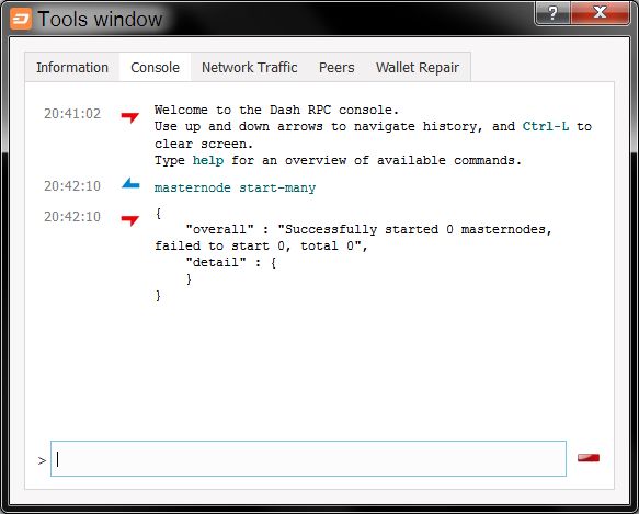

So I just closed and re-opened my wallet, 3 tx have 16 confirm, 4 have only 14, and 5 have only 12 confirm; I was expecting 3 to start, but

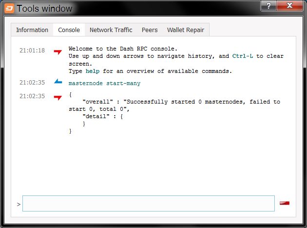

I left the wallet closed for at least 5 minutes (now up to 16 confirms minimum), issued start-many command... sorry, same result:

I keep closing my start-many wallet (5 mins), re-open and trying star-many again, but successfully started 0 each time;
however no hanging on close - in fact, it seems to close quite quickly.

Hmm, I've had no successful starts... I'm going to edit masternode.conf... all I can think of maybe there should only be 1 space between each field (not 2 spaces like I have)... I have a script generates it for me
Edit: well, that didn't help... but if you're able to to start MNs on his cloud, I must have screwed up somewhere... I'll check
Yes, only one space in between each field. No space before next line. No space at the beginning or end of the list.
