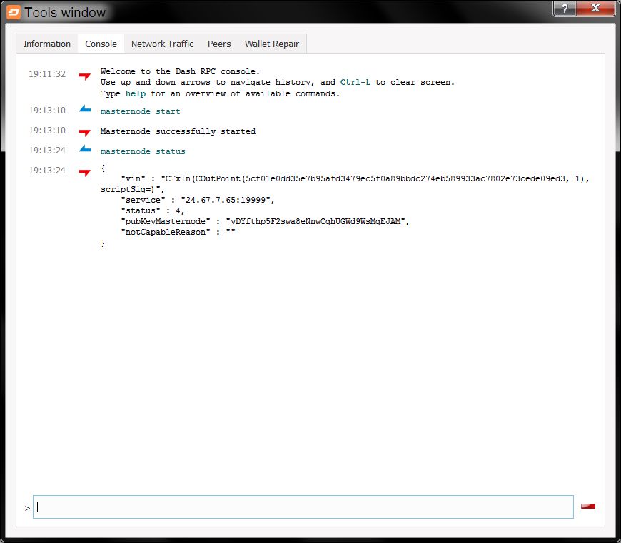

Is there anywhere posted an explanation of the result obtained from "masternode status" command? ... the numbers listed for "status" in particular?
Afaik, none. I'm puzzled about that command too.
Glad I'm not the only one... for status I've seen results from time to time of 0, 1, and 4... suggesting there is probably also a 3.
If someone would post an explanation here, we could that as official documentation for others' future reference.
Anyway, I have a local hot wallet running a MN all day - it was "successfully started" and has had current "status" = 4 ever since. it shows as "ENABLED" using masternodelist full command, but has received no payments at all.

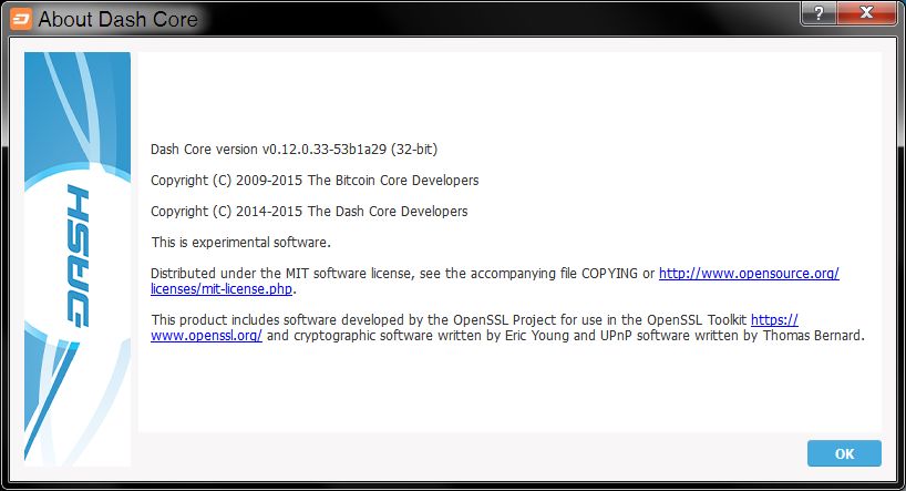

Wallet still has freezing issue, and maybe some other issue, idk. But Evan is on it.
windows: https://dashpay.atlassian.net/builds/browse/DASHW-DEV
build number 222
EDIT: HOLD ON.. something is wrong let me check with evan.
Here's the codes from masternode.h
16 #define MASTERNODE_INITIAL                     0 // initial state
17 #define MASTERNODE_SYNC_IN_PROCESS             1
18 #define MASTERNODE_INPUT_TOO_NEW               2
19 #define MASTERNODE_NOT_CAPABLE                 3
20 #define MASTERNODE_STARTED                     4
Than you very much!

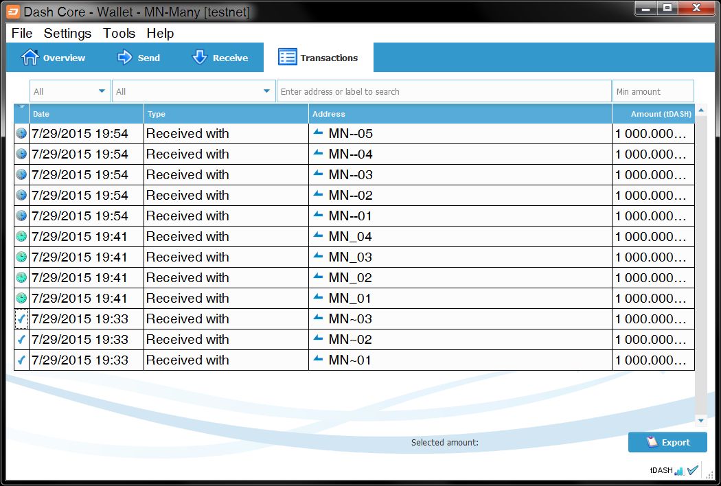

Just waiting for 15 confirms to start 12 with scratchy's cloud:
ahahahaha... i was about to ask if you're running MNs on his service... Now when you're ready, please test "masternode start-many", then shut down, wait for 5 min, restart the wallet and do "masternode start-many" again. If the wallet hangs when shutting down or freezes when you start the mns, please report. Thanks :)
