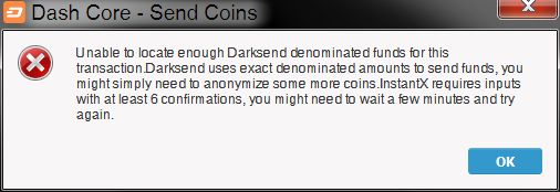

Message I get when trying to combine TX+DS, (from wallet with 1946 Darksend balance, all with many confirmations):
That's most likely the limitation of DS and not IX - you need to have enough denominated inputs to sent that exact amount you're trying to send +- 0.1
What's in your coin control and what amount are you trying to send?

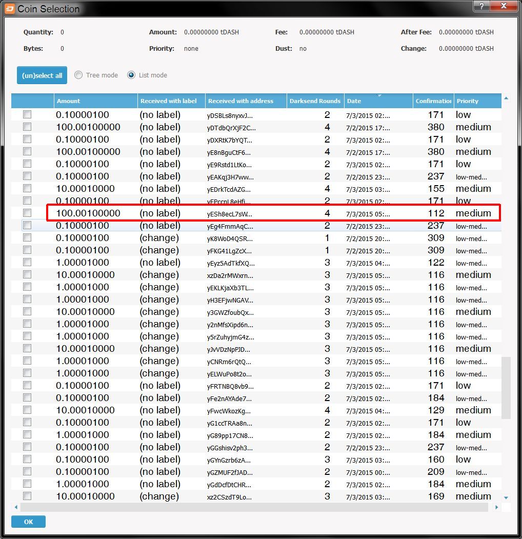

I am able to successfully do DS tx by itself. When combining DS+IX, maybe I should preselect inputs prior to sending?
Edit: I tried sending assorted amounts... 10, 50, 100, 110 coins
Here is partial pic of my coin control:
Calculation is ok - because of DS your fee is 5 tDASH (check coin control features section)
This keeps happening to me too. What is it that causes such a high fee. you can see there he wanted to send 5 coins, and got a 5 coin fee. How can that happen? It happens to me, using DS and IX at the same time, choosing outputs or letting the system choose.

What was your minimum mixing rounds?
Maybe what's happening is that the minimum mixing rounds aren't there, so there aren't enough small inputs. If you're sending 5 coins, and there is only a denomination of 10.001 coins that could be used, the system has to tell you you're sending out 10.001 coins with 5 going to your intended, and 5.001 being a fee?
DS doesn't do change, right?
Or does it? Do we have to create a "custom change address?" I've never used that before. And why does DS alone work?
On mine, I have many inputs > my selected rounds (5) and can't DS + IX together even when selecting the inputs myself.

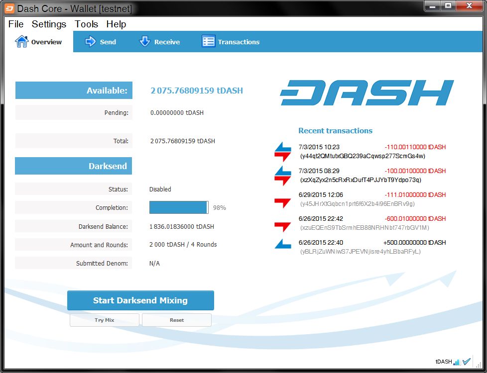

I have it set to 2000 coins/4 rounds; and "Completion" bar was at 100% when I first tried the combined DS+IX tx, until I sent 100 coins using DS alone (that is most recent tx shown). Here's a pic:

There is no change allowed for DS txes. Everything that is leftover is going to be a fee.
