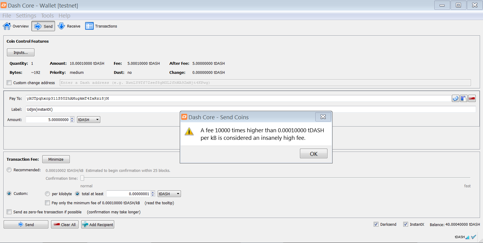

I have a problem with the fee saying it is insanely high at 10,000 times (incorrect calculation)
Recommended and custom settings refuse to allow me to send instantX and Darksend at the same time.
Here.
Calculation is ok - because of DS your fee is 5 tDASH (check coin control features section)
