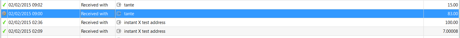

just sent some to you
Status: 5/confirmed (verified via instantx), broadcast through 2 node(s)
Date: 2/1/2015 23:27
To: y2NevUPYyY4Vh4s71Wy6PHLEisEepqNRmN
Debit: -83.00 tDRKNet amount: -83.00 tDRK
Transaction ID: c98a32b472a741b76fcf3daf68183a9cafa40ea7495cc868a42664d14147e195-000
Oops, I'm on version 11.1.0, trying to update to 11.1.1... slow download...
Ok, looks like version # wasn't updated I also didn't realize I needed to click instant x on the choices, LOL. So I did a few, but one seemed to take over 30 seconds, but I didn't time it, got my phone's stop watch out , and tried to time the next one, and it was literally instant. Instant instant, broadcast through 1 node. I assume that means that the 1 node I broadcasted through just happened to be the chosen masternode? Is that how it works?
To: y2NevUPYyY4Vh4s71Wy6PHLEisEepqNRmNDebit: -83.00 tDRKNet amount: -83.00 tDRK
Showing instant on your end, and 1 confirmation on my end after 3 or 4 minutes.
second tx of 15 tdrk caught up and over took Moli's 83 tdrk,
I just did another, it took 44 seconds
another never gave me a check mark, but when I double clicked on the transaction, it said 5/confirmed verified via instant X but I still had a ? in that column
I don't remember sending 83???
Nope, that's from someone else :)
BTW, I'm mixing while sending coins that are not ready ;) - meaning they haven't gone the specified rounds :)
NOPE that was an untruth! I forgot my wallet had been restarted, so DarkSend was off. Once I turned it on, I couldn't send funds. When I tried to enter my passphrase to send funds, it would error out saying my wallet was unlocked for denominations only. I tried it after setting Darksend with the wallet unlocked for denomination only, and just unlocked fully, but the reacation on the send tab was the same. Is this intended behavior?
You?
Status: 5/confirmed (verified via instantx)Date: 02/02/2015 09:18From: unknownTo: y2NevUPYyY4Vh4s71Wy6PHLEisEepqNRmN (own address, label: tante)Credit: 50.00 tDRKNet amount: +50.00 tDRKTransaction ID: 7f9f3084c1c38a7a85a139ecb29bb935bad30969d5a5df2acce98e8155f098f8-000
Ok, lets see, I did... um I did 15 then 5 ... hey, I sent more, but they're not on the transaction list anymore! Could they have been reversed?
Maybe I don't remember correctly, so let me try a few again... I easily get confused
I think we're both on about the same level lol.
Ugh, Ok, I was trying to send while mixing, and as I reported above, I got an error that couldn't unlock my wallet when I tried to send. I've tried to stop Darksend, and still couldn't send, so I tried going to Settings > unlock wallet, unlocked it, and still could not send for the same error I reported above, I guess I'll have to stop and restart the wallet to reset everything and make it work again ;P
Ok after resetting, I sent 6 coins and didn't get a check mark, but when I double clicked on the transaction, it said 5/confirmations (via instant x) so ??? Is it working?
Ok 1 minute 35 seconds for the last instant to turn into a checkmark. I guess that's it for me tonight. I need to go to sleep ;P Good night!!!
I think so, as it says instantX, I am now getting a hit rate of about 80% where as last night it was 30%.
