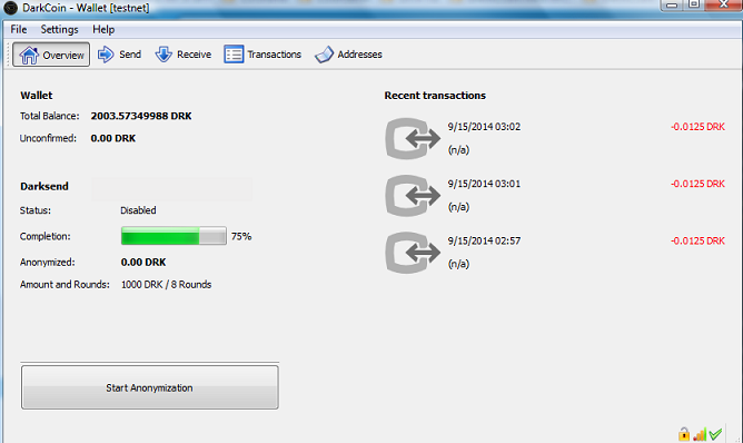

I think the confusion is the progress bar shows the completion of the rounds (which is actually the anonymization process), but doesn't show the anonymized coins (which are not anonymized as specified yet). So when there's 0 anon coins on the screen and the progress bar shows 75%, it can be confusing for some people. Here's an example:

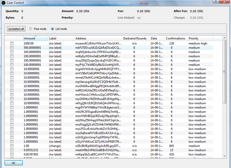

I have 0 anonymized tdrk, yet, the progress bar says 75%. But, let's look at the Coin Control screen, it shows all my denominate amounts have finished 6 out of 8 rounds, and that is 75% of the process:
So the Coin Control is where it holds the information, and for some of us, we prefer to look for the info there.
