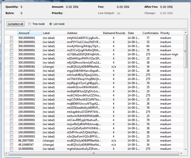

The anonymization has finished. My wallet now has 5456 anon tdrk.
Coin Control shows how the money was split up in the final step:
