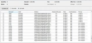

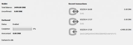

- Total Balance of yr wallet - 2499
- Amount of Darkcoin to keep anonymized - 50
- Pic of your coin control inputs on List Mode
- Pic of yr transactions
- number of Darksend Rounds set for yr wallet (i think you mentioned 8?) - 6
- confirm Darksend status : enabled - Yes
i do think the problem is with the Amount of Darkcoin to keep anonymized - 50 when you have a large amount (2499 in yr case)
try raising to 150 to see if that kickstart anything .. then work back to see where exactly it stops working.
We can make a bug report then.
Set to 100 without sending the coins to myself, got my first darksend denominate. Wonder if there is a threshold that as a percentage of the total balance is too small to initiate. Might be worth others trying to replicate smaller thresholds as well as it will take time going through rounds.
