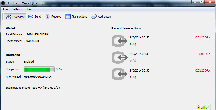

I'm participating in this testing as an end user as well, using the windows wallet which imo will be used by mainstream users. Anyways, after being WOWed by the speedy anonymizing of the first 1000 drk... I spent 300 drk, and received 701.99 drk. I left the Options settings the same (1000 drk to be anonymized at 8 rounds), but nothing happened overnight.
This morning I changed the amount to 800, waited, the anonymization progress bar stayed the same at 86%. Restarted the wallet, waited, the progress bar was still the same. Changed the amount to 1000, waited, it didn't make the anonymizing to budge. There have been talks about we can make it even more anonymous by going through 8 rounds a few times. Can this happen yet? How?
I understand that the anonymizing has to wait for compatible pairs, but I'm wondering if this is a bug. The first initial 1000 drk were anonymized fast, but it seems the next process is halted or something.
