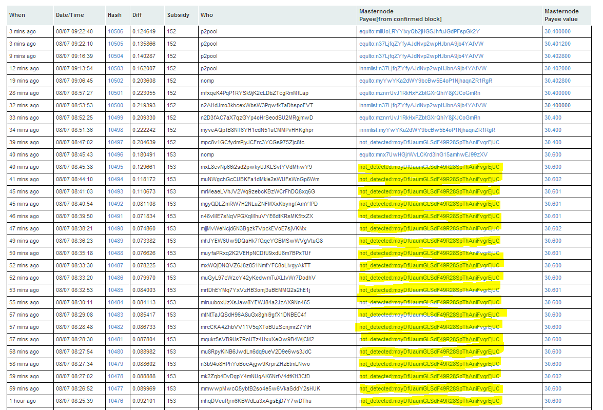

I don't know why it kept paying me back the full amount. I am currently running 0.10.12.16, which seems to have some bugs.
I seems your miner wallet sees only one masternode (itself?). Could you run
$ darkcoind masternode list
on this wallet?
