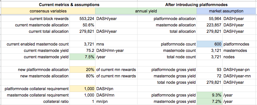

An alternative to consider:
1. Make running platform services optional
2. Require collateral lockup to run a platform masternode.
3. Maintain 1,000 DASH collateral requirement for all masternodes:
- 1,000 DASH for core masternodes (as current/normal)
- 1,000 DASH locked for platform masternodes (see below for lock time considerations)
4. Launch conservatively and limit participation (do a beta launch)
- high initial lock time period (e.g. 1 year)
- low initial platform node allocation (e.g. 10% of masternode allocation)
5. Refine over time
- observe data (costs, performance, stability, which nodes have upgraded, etc)
- fix bugs and adjust consensus variables until dialed in:
- decrease lock time period (e.g. to 6 months) to increase node count (e.g. to 400 nodes)
- increase platform allocation (e.g. to 20%) to increase node count (e.g. to 600 nodes)
Example:
(numbers not set in stone, just for illustration)
Why?
2. This solution satisfies the main stated goals of the "high performance masternode" proposal:
- It can mitigate the risk of multiple platform nodes dropping off with staggered time locks.
Is this to be considered a temporary fix to the risk of multiple platform nodes dropping off, untill DCG comes up with a definitive solution ?
Or do staggered time locks provide a longterm fix to the risk of multiple platform nodes dropping off, even after the timelocks unlock ? (lets say for example the time locks unlock after 1 year)
What i am wondering about is if we still have this problem (the risk of multiple platform nodes dropping off), after that timelock expires in a year or after six months.
Is it a case of buying devs some time to implement something more permanently ?
It's not a fix in the sense that it guarantees no risk (it just mitigates, not eliminates). The degree of mitigation would depend on the implementation.
My original thought with timelocks is simply that whales (especially 3rd party custodians) would not want to lock up all their nodes at the same time (regardless of timelock duration). Imagine you have 100 nodes, would you want to lock every single one up at the same time? Unlikely, because a) then you then have zero liquidity, and b) you don't want to get into a situation where your platform masternodes are less profitable, for whatever reason, than your normal masternodes (or other non-Dash alternatives for that matter). You might lock only 25% or 50% of your nodes, and/or stagger them over a time period. For example you might spin up 10 now, 10 more in a week, another 10 in another week, and so on until you're satisfied that you have a stable, relatively liquid investment that is more profitable than your alternatives.
The point is, with timelocks, it's very unlikely that you'll ape in with all your nodes at the same time. If that's the case, then there's much less of a risk to the platform that huge amounts of nodes by one entity will suddenly drop off, or be upgraded at the same time. That's the main risk as I understand it, so, problem significantly mitigated.
I imagine under timelocks that we'd see a relatively slow, smooth influx of small amounts of nodes from dedicated operators at first. They would be handsomely rewarded for being the first in (and you don't have to be a quadra- or deca-whale to have this opportunity - just need to be dedicated to holding Dash). Because there's a higher barrier to entry you won't see a mad rush of operators switching over their whole fleets on day one, which is exactly what you want.
So I think it both buys devs more time (without a drastic and hasty collateral increase) and, depending on what we see in terms of which nodes decide to run platform, it may even offer a permanent solution with even a one-time timelock. The timelock requirement could potentially even be removed in the future if we see a well-distributed mix of operators (no 130+ node operators, for example).
