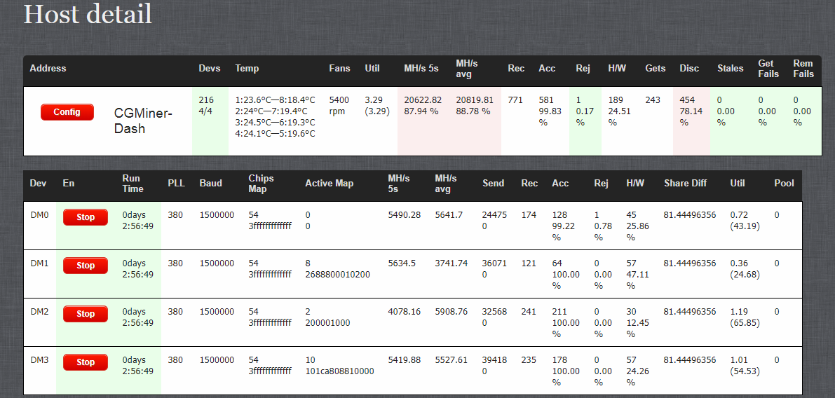

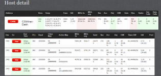

second screenshot
using the other browser Opera all interface is displayed correctly.
I do not know what the problem may be, given that the first browser from which screenshots were taken were Сhrome, and since the launch of the miner I have used only it. Therefore, while I decided not to update anything. In addition, after reading your instructions, the following question arose - in your instructions the 4th item looks like this:
"Insert the flashed TF card into PI, and power up the miner box to mining"
What means "PI" here?
Hi,
I know that there are display issues when using Internet Explorer or Edge but this is the first I have seen with Chrome. It could be a Chrome update or something. The "PI" from the instructions is the PI controller board.
