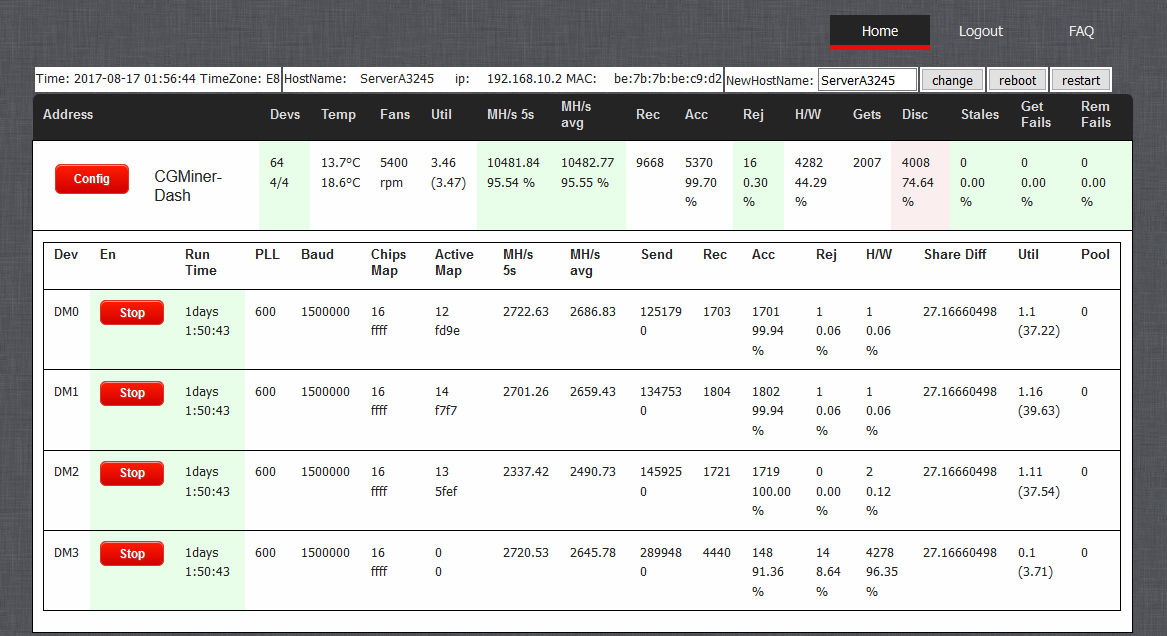

Hello Ibelink_1!
I think that my Ibelink work not good. Something wrong with DM3. What you reccomended?

Hi pmaxx,
Sorry to hear you are having issues with a blade. Have you tried rebooting the miner? If you keep getting high H/W after rebooting, you will need to do the Single Blade Test. Use the guide on our website to check what is wrong with the blade. If the one of the hashing board is bad, you will need to submit a ticket to get the RMA process going.
I rebooting the miner many times. I can not check Ibelink right now. I have a next question. If I will make Single Blade Test, and one of board is bad, could I remove it and send to the seller that you change it? I don't understand, will the iBelink work without one or some hashing board?
Hi pmaxx,
If one of the boards is bad, you can remove it and get it replaced. The blade will still run even if it is missing boards. Just group them so they are all next to each other.
Could I write on Russian? As I understand, I will check the blade(DM03), found the bad PCB(s), replace all other on blade from 1 to 6 one by one for example, and that send the bad PCBs to reseller. Am I right? I try to understand, can the first PCB on the blade obstructing the work to others PCBs of the blade?
Hi pmaxx,
Yes, you will check the blade (DM03) and find bad PCB. Then replace all the other PCB together starting from 1. For example:
normal
1 2 3 4 5 6 7 8
PCB 4 is bad so order is now
1 2 3 5 6 7 8 empty
Also, the first bad PCB will obstruct work to the other PCB behind it on the blade. I hope that makes it clear.
