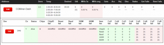

how to proceed from here, I also put the switch to the same as the board, didn't work
Hi,
The switches are only used for setting the temperature detection. It looks like hashing board #5 is bad. You will need to check if hashing board #6 to #8 are ok by following the Single Blade Test Guide. This involves moving the panel board and re-attaching it. Next you would need to request for a RMA from Request Warranty on the website.
