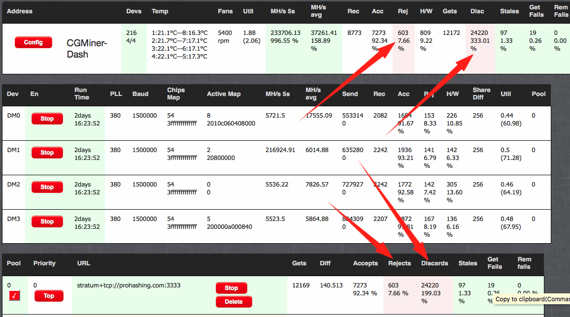

upload_2018-1-11_23-6-25.pngGreetings to all. Who knows what these red fields stand for? what's wrong with my miner? What can be done? Maybe the memory card is not working? Thanks for the answer...

View attachment 5845View attachment 5845Greetings to all. Who knows what these red fields stand for? what's wrong with my miner? What can be done? Maybe the memory card is not working? Thanks for the answer...
Hi,
Those fields are Rejected and Discards. Those are things that occur normally while mining. Discards are usually affected by communication with the pool due to latency. The more time it takes to communicate with the pool, the more likely the work from the block is invalid and will be discarded. You can try looking for a closer pool if you want, but there is nothing wrong with your miner and your memory card should be working fine.
