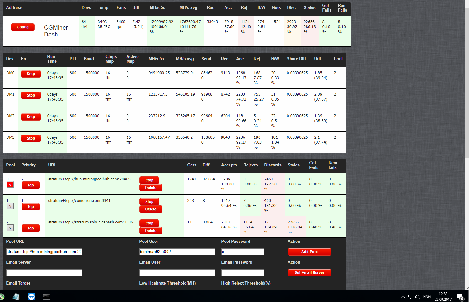

Hi, support.
I need your help and advice.
Due to the increased catastrophic mining difficulty on pools I've decided to start mining in Solo mode. I've launched the miner with nicehash settings as the it was written in the instructions.
But when I launched my DM11 for solo it shows unreal huge hashrates and LED indicators blinks red every minute.
So maybe I am doing something wrong and want to know your opinion: Is it good idea to mine in solo mode if i have 30 ibelink DM11 machines?
Thanks in advance.

Hi,
The huge hashrates you are getting is most likely a wrong difficulty setting. The LED blinks red is caused by the miner detecting this unusual reading and restarting the blade. If you can raise the share diff of your miner, you should start to get normal hashrate readings. For your question about solo mining, in my own opinion you can solo mine. If you want more opinions, you can join the Dash Slack and ask the people there. They are very friendly and helpful. You can join from this url https://dash-nation-invite.herokuapp.com/ and join the #mining channel.
