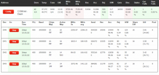

hi ibelink ,
i am using nicehash and i find out my mining performance is pretty low on average .
may i know whats the possible reason and i have only taken out one price of hash board ,
i am expecting 3% of performance lost only but according to the average hash rate is around 30% lost.

Hi kitkit85,
Aside from using 1 less hashing board, the PLL (clockrate) has also been lowered due to a high temperature. If you can bring that down to a reported temperature of around 35C, the PLL will be returned to normal and you should get a better hashrate. The normal (and highest) PLL setting is 600.

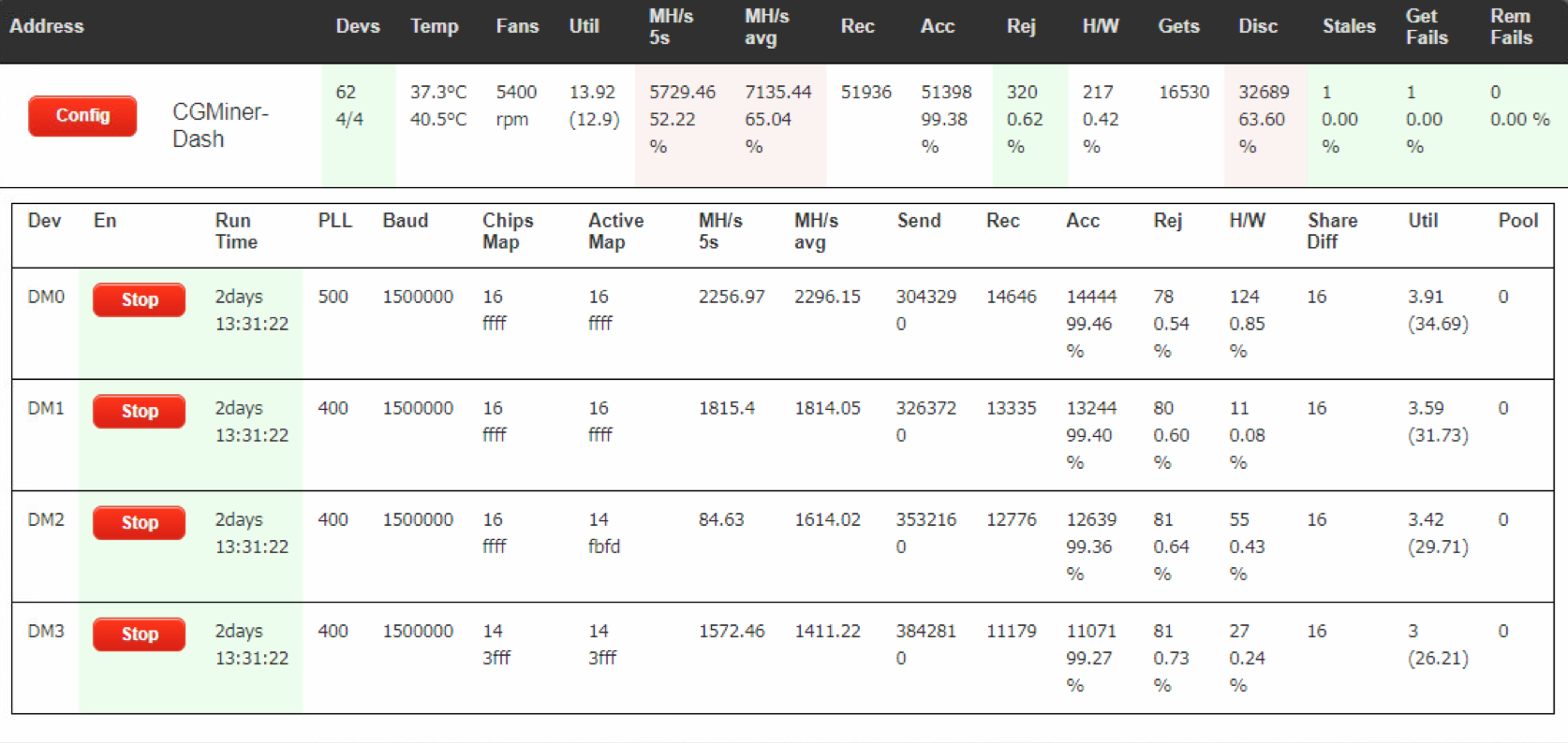

Hello, support.
One of the four LED indicators is off on my iBeLink DM11G machine. Find attached the screenshot from the miner. It shows that it is working and it's hashrate is included into total hashrate. But look at the Active map column, it shows zero.
Is it normal? I think it is inactive. Waiting for your reply.

Hi,
When you say the LED indicator is off, do you mean it is not lit? Not red or blue? It could be that the LED has burned itself out. From the screenshot, all the readings are indicating your hardware is still good. You are detecting 4 blades, 16 chips each and running at 600 PLL and low H/W.
The Active Map values do vary and will sometimes show a 0. This is normal as it will change again. If it stays at 0 for a very long period of time, then you will need to restart the miner.
