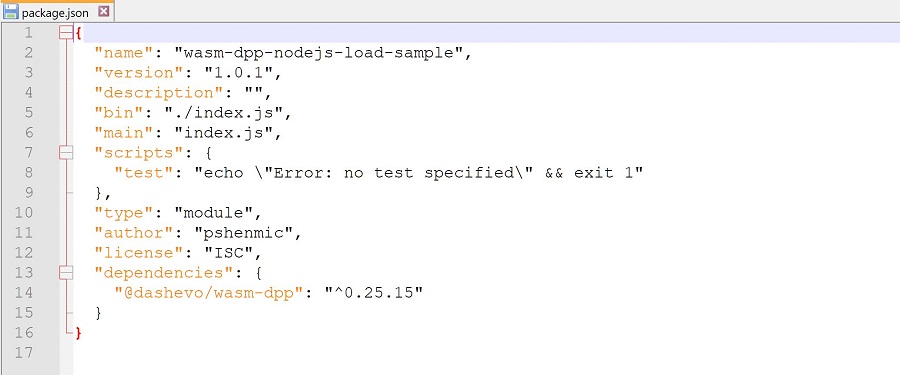

I made a sample application to reproduce your case, could you please clone this repo https://github.com/pshenmic/wasm-dpp-nodejs-load-sample anywhere on your system, and try to run it: `node index.js`
On my side, it loads successfully:
% node index.js
Wasm DPP successfully loaded

Cloned directly into my home directory.
~$ git clone https://github.com/pshenmic/wasm-dpp-nodejs-load-sample
$ cd wasm-dpp-nodejs-load-sample
$ npm install
$ node index.js
CompileError: WebAssembly.Module(): Compiling function #331:"memchr::arch::wasm3 2::simd128: packedpair::Find..." failed: Wasm SIMD unsupported @+1955693
Node.js v20.10.0

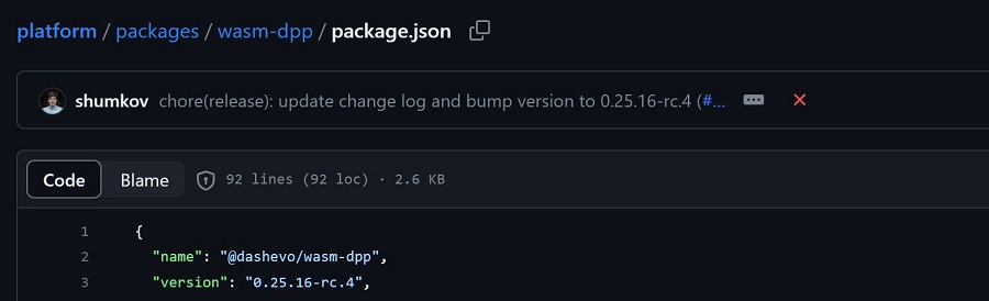

Maybe the problem is with @dashevo/wasm-dpp (incorrect workspace ?) listed as dependencies for v.0.25.15 ?
Actual workspace : https://github.com/dashpay/platform/tree/v1.0-dev/packages/wasm-dpp ?
Even v0.25.16-rc.4 is currently linking to incorrect workspace @dashevo
But in any case, reproducing the same error on my side has been successfull with your sample application.
I will add this information to the platform github issue (https://github.com/dashpay/platform/issues/1583).

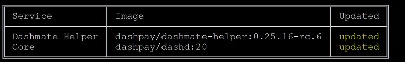

this v0.25.16-rc.6 works for me.
I used a slightly different approach
dashmate stop
npm install -g [email protected]
dashmate update
dashmate start
Dashmate status will show exact Core version (v20.0.2), so this is fine with regards to v20

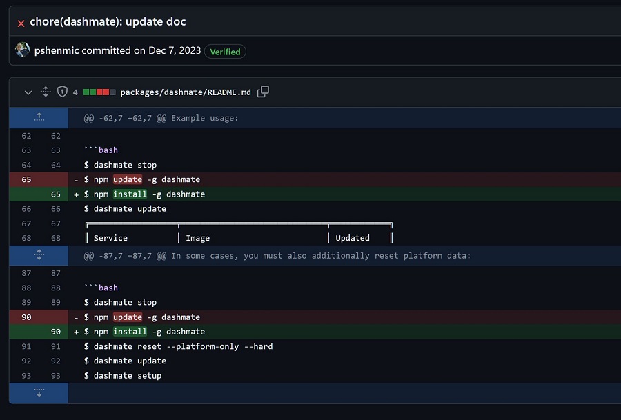

Casually changing Dashmate update instructions without informing Dashmate users about this ?
Not cool.
So what happens when people issue npm update -g dashmate ? do they get a notice that they should be using npm install -g dashmate ?
With which Dashmate version does this change get active ? I did a npm update -g dashmate on my Evonodes yesterday without problem,
which got me to Dash Core v20.1 / Dashmate 0.25.22 so i assume this change gets active with Dashmate v0.25.23 ?
Or do commands npm update -g dashmate & npm install -g dashmate continue to coexist with each other ?
Which means Dashmate users can use either :
dashmate stop
dashmate update
dashmate start
or
dashmate stop
dashmate update
dashmate start
For a simple Dashmate update through npm, i would actually prefer to continue using npm update -g dashmate
For an uninstall and install of Dashmate through npm, npm install -g dashmate makes more sense (i am already using it that way, though i rarely needed to use it)
Not cool.
dashmate stop
dashmate update
dashmate start
or
dashmate stop
dashmate update
dashmate start
I don't remember if there are documents suggesting you to use `npm update`. The difference is that `npm install` is always picking the latest version of the package, while `npm upgrade` will perform some semantical versioning from your global package list. Those two commands do almost the same thing except npm install forcibly install you the latest version from the npm.
