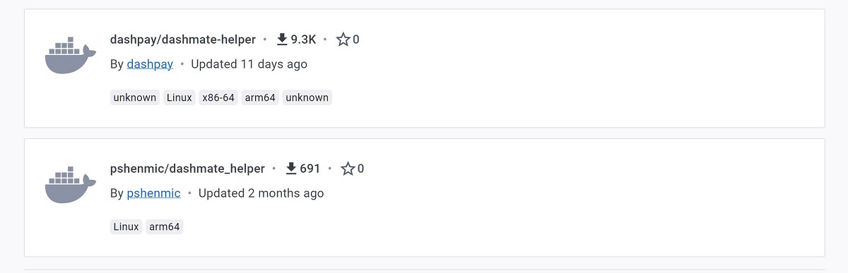

@pshenmic
I am getting :
Error: (HTTP code 404) unexpected - manifest for dashpay/dashmate-helper:0.24.20 not found: manifest unknown: manifest unknown
after having updated dashmate through npm update -g dashmate
Dashmate throws that error after issuing command dashmate update and won't allow a dashmate start for me.
Is the dashmate helper updated through Docker as well ? If yes, then i don't see Dashmate v0.24.20 on Docker :
Latest update there seems to be dashmate v0.24.19 from 11 days ago.
Source : https://hub.docker.com/search?q=dashmate

I tried installing dashmate again through command npm install -g dashmate and then update it again with command npm update -g dashmate --> same error & same problem (will not allow dashmate start).
I tried installing dashmate again through command npm install -g dashmate, without issuing npm update -g dashmate (hoping that would get me to an older Dashmate version) --> same error & same problem (will not allow dashmate start).
Github issue : https://github.com/dashpay/platform/issues/1303
This needs urgent attention, as i can not start dashmate right now.
I would also like to know how i can revert back to a previous dashmate version (v0.24.19 in this case), in case of above situation occurring again in the future. So that i can at least start the dashd Docker container, while waiting for a solution.
