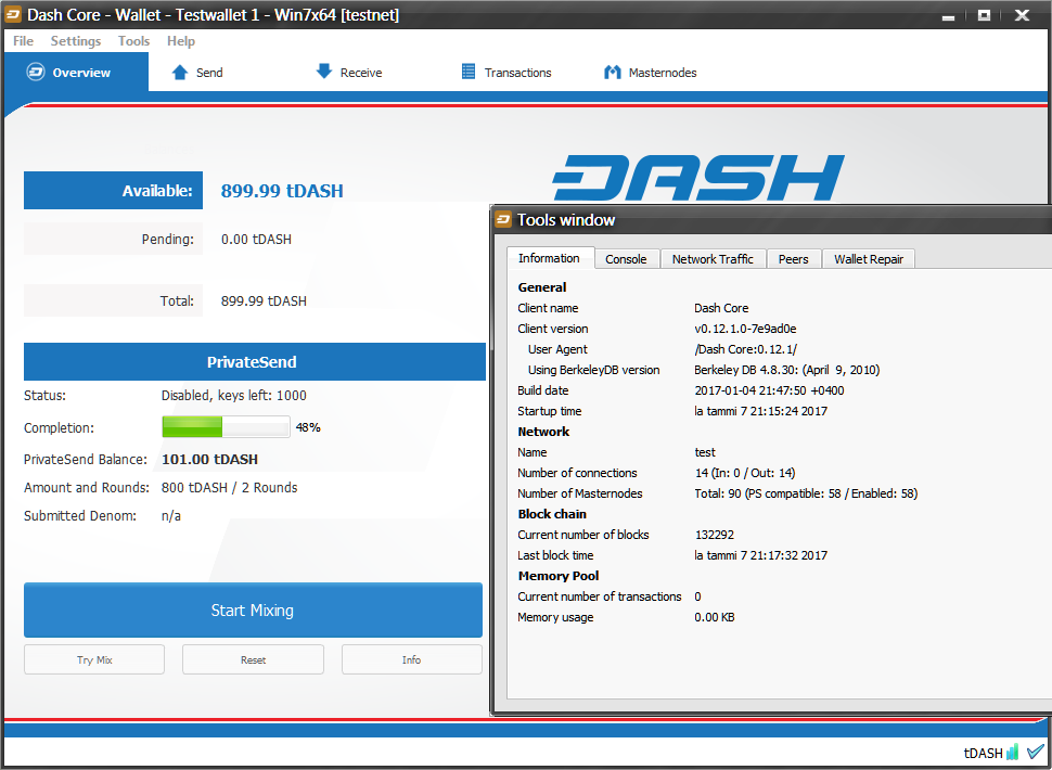

- PS completion % is wrong.
- Mixing does not work.
- Sync loops 2 times in the row.

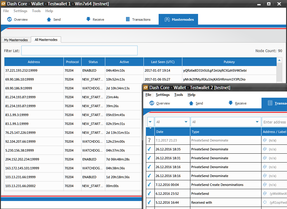

- Masternodes tab date is wrong format again (fixed once: https://github.com/dashpay/dash/issues/796)
- Translations ?
I'm worried...
