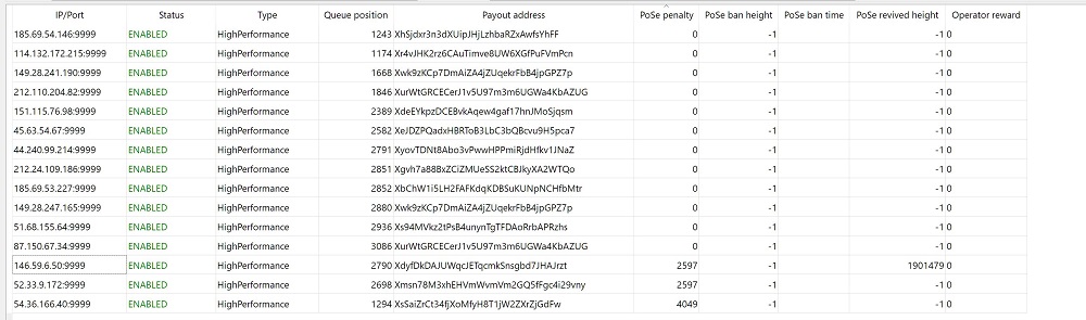

I wonder why some of these Evo nodes got relatively high Pose penalties, specially with Spork 23 (quorum pose) not even active.
How can an Evo node even reach a PoSe penalty score of 4049 and still have status ENABLED ? We only have 3309 normal masternodes and 15 evo nodes in total. That PoSe score number 4049 does not make any sense to me.

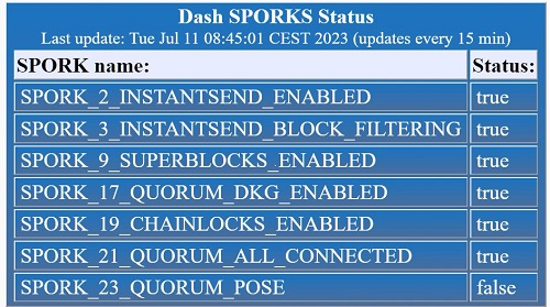

I also wonder if there is any feedback about when spork 23 will be enabled by DCG and when the message 'unknown new rules activated (version bit 8)' will disappear from the Dash Core wallet, now that v19 is fully activated.
The clue lies with Stevie Wonder who seems to be doing something very wrong.
I am just surprised how an Evo node can do something very wrong and still maintain its MN payment que and is still on status 'Enabled'.
Should an Evo node with a PoSe penalty of 4049 not be PoSe banned by now with status 'PoSe Banned'?
Feels to me like Evo Nodes are currently (with v19) immune to PoSe Penalty scores. They can receive them, but it does not affect their MN payment que. In other words : an Evo node can currently fail miserably on L1 (PoSe penalty of 4049) and still get fully paid to do work on L1.
How high can these PoSe penalties get for Evo nodes ? PoSe penalty 4049 already exceeds total number of masternodes & Evo nodes.
EDIT : never mind, i see that Evo node is actually PoSe banned now, after it reached PoSe penalty score 4353.
I guess PoSe penalty score formulation take into account 'Total number of masternodes' (4338) and not 'Active number of masternodes' (3289).
(4338 + 15 = 4353 ===> PoSe Ban)
So ignore the above, it looks to be working correctly.

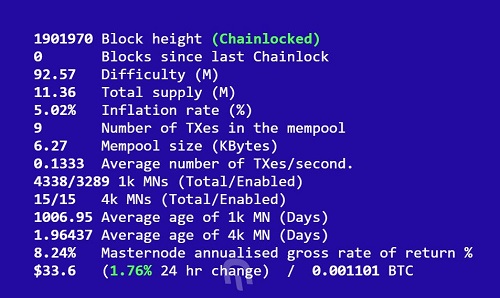

By the way : is that 8.24% ROI correct ? Seems a bit high. Is it taking into account both 1K MN's and 4K MN's ?
A lot to unpack here, it seems the PoSe score is based on the number of nodes in total, not just activated.

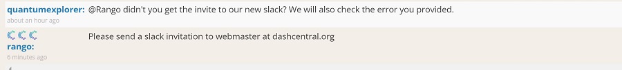

See reply of rango (owner of Dash Central, in the shout area of DC) :
Maybe someone can alert DCG and have them contact rango from Dash Central ?
This is also exactly the reason why it would have been usefull to have kept a communication line open between DCG and Dash Central (as i previously mentioned here) with regards to v19 activation and the launch of Evo Nodes.

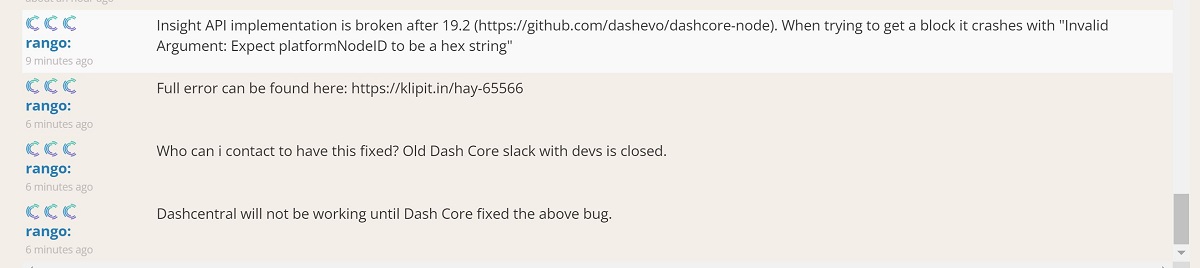

Latest update :

Now we are in a situation that Dash Central faces problems due to the v19 activation, appearently related to a bug in v19 that DCG needs to fix on their side. The result is that Dash proposal owners can not currently claim their proposals and edit their proposal texts on Dash Central and to a high degree Dash Central is currently also inoperative.
And it is totally unclear If Dash Central will even support Evo nodes (i could not get a straight answer from rango about this).
What i do know is that Evo nodes are currently cut off from budget proposal and decision proposal discussions on Dash Central and can also not vote through Dash Central, which is not a good development.
