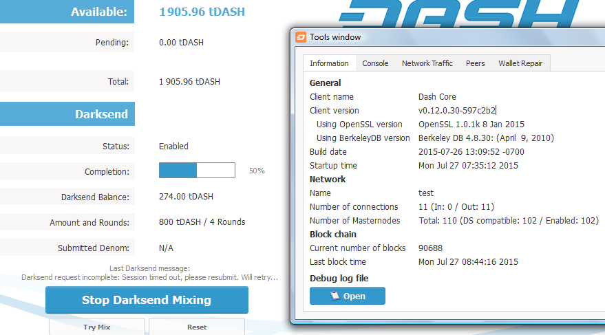

UdjinM6 - I'm trying to run DS mixing on 4 wallets but something is wrong with DS in this version. DS is either idle or timed out. I've tried the buttons "Reset" and "Try Mix", they can do one denominate tx then back to timedout and idle again.
Evan, but I have 4 wallets up. Let me get the latest build.I don't think we've changed anything with DS in a few versions, so it can't be broken. Actually, I just turned it on and I got mixed instantly. So I guess no one was mixing except for you
