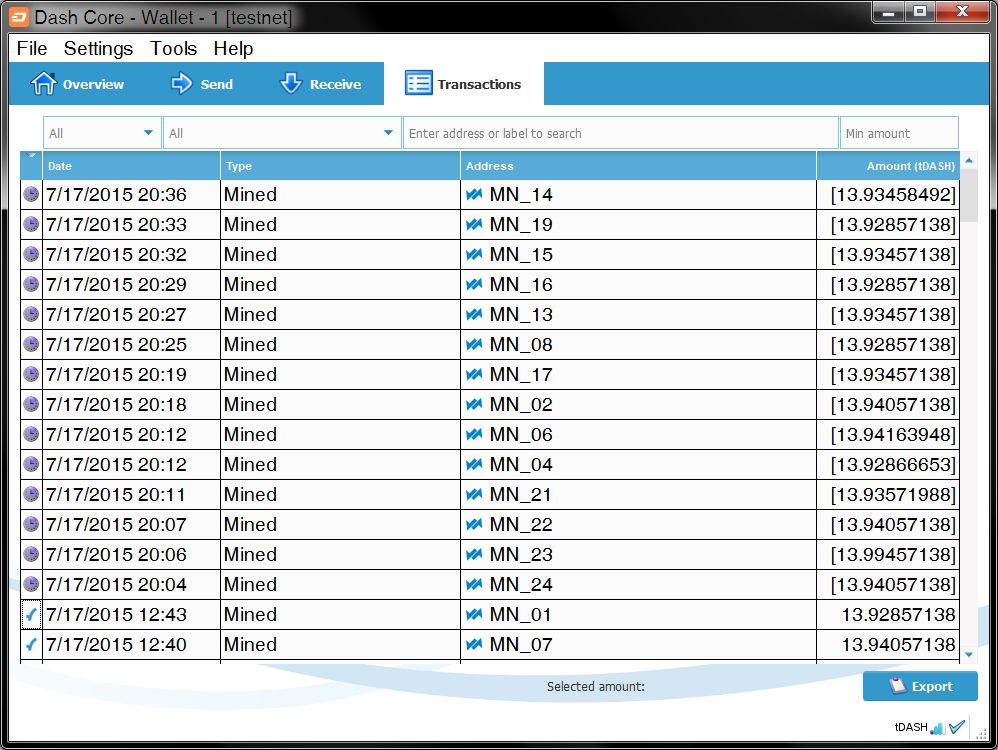

A couple of hrs ago I did a start-many on MNs that have no live daemon (according to scratchy anyway)... Lol, they're getting paid:

This doesn't mean it solves the dropping issue on scratchy's server though? Because scratchy still has to figure out why the nodes get dropped from his server?
The system stabilized, the nodes are not crashing / dieing anymore on the latest commit.

- The reason why they getting payed is that you started them once with the 'normal' start procedure.
No, I only ever started them using start-many.
- You were creating new nodes on our page instead of using the existing ones.
No, I created 3 groups of nodes - 10, 10, and 4, and just kept re-starting (which was often because they kept going down)
- Maybe with wrong node parameters/maybe you were to slow to start them. (they expire after 2 hours unused)
No, each time I created a group of nodes, I immediately fired them up using start-many, and they showed up on masternodelist as "ENABLED".
If you still own the unique url on masternodecloud.com you can check the status.
Yes, I randomly selected and checked about a half a dozen or so - every one showed status as "This url seems to be expired".
- After that you always tried to start them with start-many, which looked like it was successfull but it wasnt.
For sure, that was an issue you pointed out, and the devs have fixed it with this latest release.
- In the backround some of your nodes were still running on our cloud enviroment thats why they getting payed.
Ohh, I was under the impression you shut down all 24 of MNs - lol, apparently not?
Im working on the ability to restore your private url on our cloud system. If you lost it.
Cool, I'd prefer to not redo the entire setup process all over again.
Right on.
