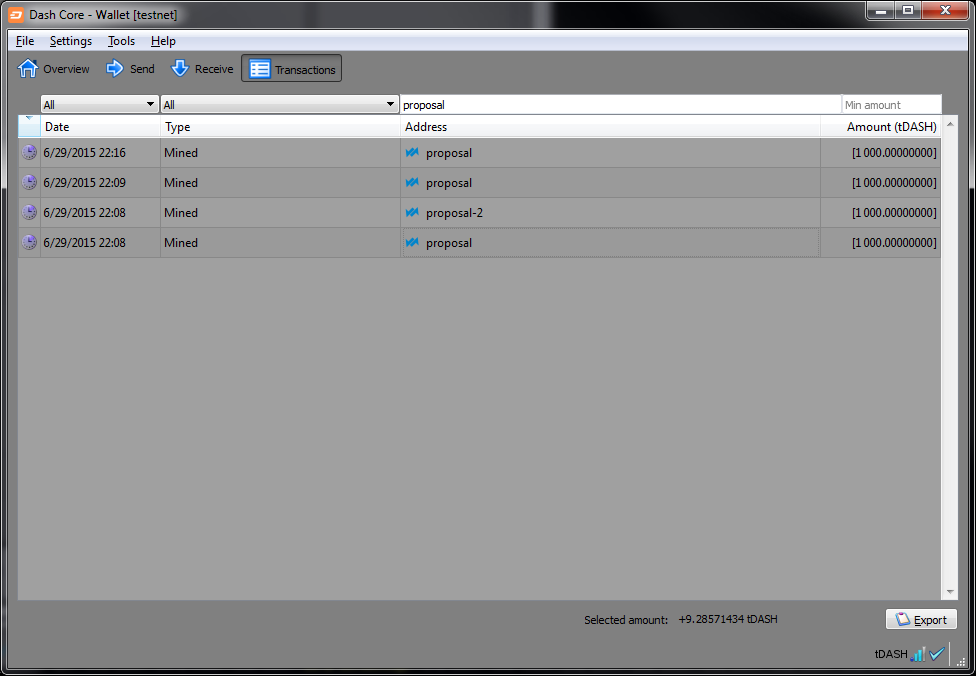

i have no idea what below pasted printscreen means .. but interesting :)
edit : moo's proposal is through as final budget i think, the third one (his hash starting with bd9..) is mentioned.

Got funded! Four times! D'oh!

ubuntu@node-master:~/testnet$ knssh 001 'cd testnet ; ./dash-cli -datadir=. mnbudget show'
    "proposal-moo" : {
        "URL" : "https://www.masternode.me/proposals/moo.json",
        "Hash" : "8745f503780eb5d174e51b08070a4389137388799c4fbde800f1f6c480f5da41",
        "BlockStart" : 75000,
        "BlockEnd" : 80025,
        "TotalPaymentCount" : 100,
        "RemainingPaymentCount" : 84,
        "PaymentAddress" : "y4uESG43teypVWPx2dwREundfMy8S62MEW",
        "Ratio" : 0.00000000,
        "Yeas" : 0,
        "Nays" : 0,
        "Abstains" : 0,
        "Alloted" : 100000000000,
        "TotalBudgetAlloted" : 100000000000
    "proposal-moo-2" : {
        "URL" : "https://www.masternode.me/proposals/moo2.json",
        "Hash" : "8d1c79561d3109da1995bf969baa45eaad7980a99711d9de11daac420301c87c",
        "BlockEnd" : 80025,
        "PaymentAddress" : "yBjASzqLDAmDAQXJMa5xMLocbM9k9wGTLx",
        "Yeas" : 0,
        "Nays" : 0,
        "Abstains" : 0,
        "TotalBudgetAlloted" : 200000000000
    "proposal-moo2" : {
        "Hash" : "a18bf24c1624f08d6b2ee27f1155200ccf62eddf9cae51b7df34ca71ab324872",
        "BlockEnd" : 79275,
        "TotalPaymentCount" : 85,
        "RemainingPaymentCount" : 69,
        "Ratio" : 1.00000000,
        "Yeas" : 74,
        "Nays" : 0,
        "Abstains" : 0,
        "TotalBudgetAlloted" : 300000000000
    "proposal-qwizzie1" : {
        "URL" : "http://www.dashpay.io/one.json",
        "Hash" : "bb57a8bb8069ad7292a78d9ad4de2bbe5795c452f1fdacacb916d58895202ca3",
        "BlockStart" : 74000,
        "BlockEnd" : 79025,
        "RemainingPaymentCount" : 64,
        "PaymentAddress" : "y5WWMBMxHsL5xmscwAyxUf2vfwMX58pprA",
        "Yeas" : 75,
        "Nays" : 0,
        "Abstains" : 0,
        "Alloted" : 300000000000,
        "TotalBudgetAlloted" : 600000000000
    "proposal-moo" : {
        "Hash" : "bd9db9e1ee5f2f9900b1e701a8737e5468e269a9e2de3e0c67b94161d6fd42d6",
        "BlockEnd" : 79275,
        "Yeas" : 73,
        "Nays" : 0,
        "Abstains" : 0,
        "TotalBudgetAlloted" : 700000000000
an earlier vote (made a few days ago)
proposal-moo-2 8d1c79561d3109da1995bf969baa45eaad7980a99711d9de11daac420301c87c yBjASzqLDAmDAQXJMa5xMLocbM9k9wGTLx
got paid! and was never voted on nor was it finalized. (see directly above)
yeahhhh, free tdash :)
edit : doesn't proposal moo-2 have 74 yes votes ? never mind, i got yr proposal confused with moo2 that did receive 74 yes votes.
