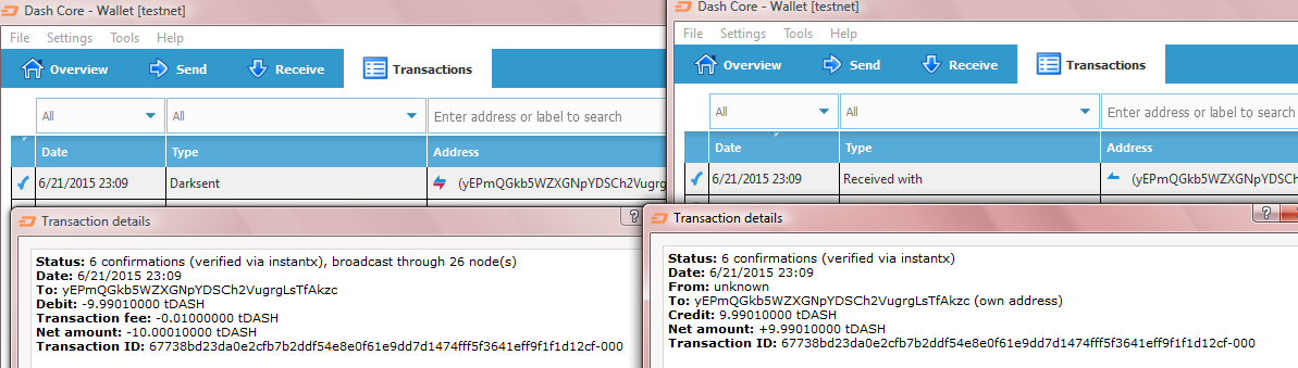

bertlebbert - most of my mixing inputs are locked so I had to unlock one input and select it from the Coin Control, then I used DS and IX and got a success:
(I did delete the fee-estimate.dat from both wallets and got a fresh wallet for both before i started testing this version). I wonder if you delete the fee-estimate.dat again and see if it works?

And we still have to use the Coin Control, then it's ok:
UdjinM6 - the IX was a success:
Status: 5/confirmed (verified via instantx), broadcast through 24 node(s)
Date: 6/21/2015 23:43
To: yAUTpqhxrp311S5U2hAMugkmT4ZaRzi8jM
Debit: -9.99010000 tDASH
Transaction fee: -0.01000000 tDASH
Net amount: -10.00010000 tDASH
Transaction ID: 1beec3f376df13bf2aa770128d86e4717ace28b011aaab709206cf70510a9dcb-000
