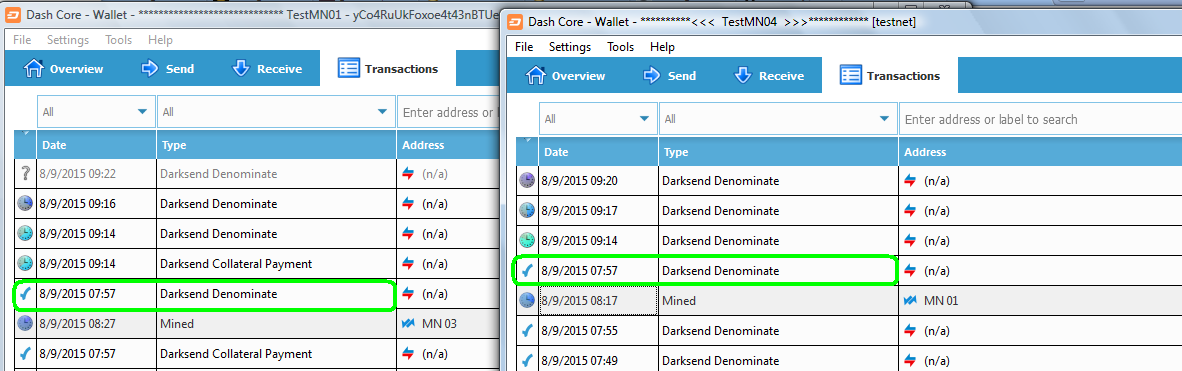

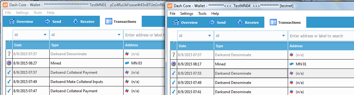

Mixing testing, but, one denominate wont confirm, multiple blocks past, its stuck.
Any idea why?
Stuck denominate : 11:56, latest block 12:13, wallet fully synced.

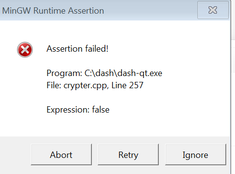

I have an error when I try to enter the password on mainnet for Dash Core version v0.12.0.40-e8ba732 (64-bit),
if I click ignore, the password fails so the wallet is unusable.
Edit: upgrade wallet format fails and salvage wallet wipes the entire balance from the wallet!!
Look in debug.log, should say "The wallet is probably corrupted: Some keys decrypt but not all."
Salvage wallet works really bad for encrypted wallets, that's a known bitcoin bug...
Nothing in debug log, I had to use a backup wallet to come back.
Interesting...
if (keyPass && keyFail)
LogPrintf("The wallet is probably corrupted: Some keys decrypt but not all.");
assert(false);
https://github.com/dashpay/dash/blob/v0.12.0.x/src/crypter.cpp#L257
Any idea why?
I have the same problem with 2 of my 6 wallets (Testdash1 & Testdash2), transactions do not get confirmed and stagnate the mixing process
Transaction id's :
5ce52957bd57b02fffa5d78107c47694f35e519c25e3d1e34a20c9dc80354cb2-000
Both from the exact same time, 14:19 hrs
edit : looks like testdash4 is staying unconfirmed too

I also have Darksend Denominates that have been stuck for an hour...
Are we having a stuck DS party? lol
(v0.12.0.40-e8ba732 - windows 32bit)

I think Testnet still has some syncing issue.... Maybe this is due to the multisig addresses we tested a few weeks ago? UdjinM6 ?
I think Testnet has some syncing issue.... Maybe this is due to the multisig addresses we tested a few weeks ago? UdjinM6 ?
but but others confirmed ok earlier when i was testing about 3 hours, but then only this one got stuck.
Yes, me, you, and qwizzie had these stuck fees.. I think it has something to do with the sync issue that the devs have been working on to solve.
