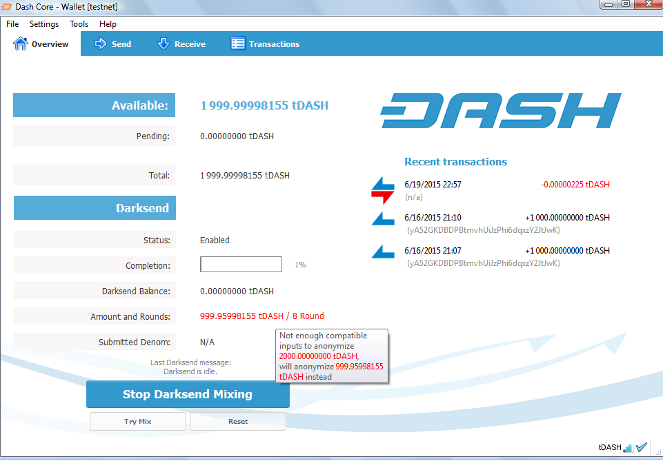

Ok here's a screenshot of my wallet and the difference between the amounts is 1000 tDASH:

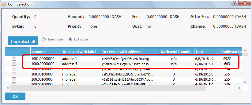

Looking at the coin control and that is the amount I got from coingun's faucet (http://test.faucet.masternode.io/)... So now the wallet is telling me that amount will not be split up to anonymize until I manually split it up, because DS thinks it's a MN?
What about poiuty's wallet? What changed his setting for the amount-to-keep-anonymized? (he said he didn't do it).
Does it also mean that if a user, without knowing about this fact, tries to anonymize his 1000 Dash, DS would not budge and the user will conclude DS doesn't work? :grin:
Yep, when you use local masternode and not masternode.conf there is no way to say which input is MN so wallet just excludes anything that is "MN-like". We can disable that but I'm not sure if that's the right move.
As for poiuty 's wallet - he basically set amount-to-keep-anonymized to some value that is higher than his balance and that's why he can see it in red on overview page (and again it shows only amount he can anonymize and not the actual settings in such situations).
Btw if you set amount-to-keep-anonymized to some value that is lower than your "anonymizable balance" you would see exact value that match settings.
EDIT: another scenario for "MN-like" outputs is when you use some additional/secondary wallet and have same private keys imported there. However we can warn user in such edge situations and still mix it if he agrees to do so but no one actually read warnings and/or instructions :grin: but, well, I agree for some users that have no idea of all that MN tech things that could look like "hmmm.... it's broken, nothing works here!!11" so let's try to find a suitable solution, I'm open for new ideas :smile:
EDIT2: hmmm, you can't actually mix in local masternode mode at all, I was wrong about that one :oops: so the only scenario I can see now is ^^^^ which I think is 1) quite rare, 2) used by advanced users who can import private keys so should be aware of what are they doing. In that case it's quite safe to disable protection of unlocked MN-like outputs (outputs mentioned in masternode.conf are locked automatically on wallet start). Or am I missing even another scenario?

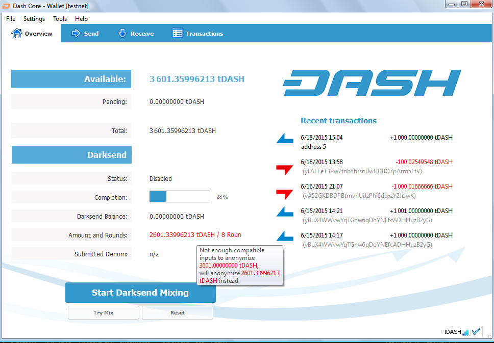

UdjinM6 - I'm checking another testnet wallet... Two 1000 tDASH amounts, "Amount and Round" are set at 1000/8 but they show "0/0", meaning DS mixing can't be run but it keeps sending messages that do not give a clue why it's not running.

So my coins are not mixing because they are still 1000tDASH amounts?
