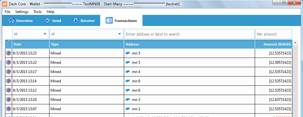

Alright... according to the plan stated on the OP of this thread...
"The block reward will be lowered by 10% a week or two after the release of v12, in preparation for budget proposals however, the budget doesn’t have to use all of this funds if there are not proposals with community support the coins are just not minted."
Here's the rewards coming to my masternodes, they are reduced by ~10% (vs the rewards before at 13.xxxxxx tDASH):

Yep, i've asked Evan to add a 10% reduction to testnet as well, which he did :)
https://github.com/dashpay/dash/commit/ef1dc8434e0b95f4aa6567bfb2fe1974e2fe57b4
