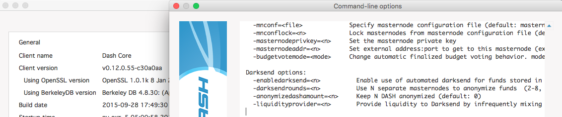

tbh, I'm not sure what we are trying to fix here and why would someone want them in help command at all - it's cmd-line option while "help smth" is for rpc
UdjinM6, I am asking for some information in the command line help to show how to anonymize funds or be a liquidity provider. It is A OK if these are configuration settings that are added to a dash.conf. It seems unreasonable to look at a qt wallet to get options for a command line wallet.
This is the closest information I see in help with dash-cli help. There is no further information by typing dash-cli help darksend. It should be simple to add the 4 missing darksend options(in pic above) between darksend and masternode commands and specify they need to be in the dash.conf.
== Dash ==
darksend <dashaddress> <amount>
masternode "command"... ( "passphrase" )
masternodelist ( "mode" "filter" )......

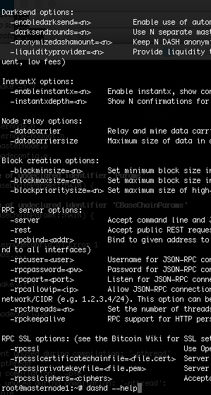

Why qt? "dashd --help", see first pic in my prev post.
There is and it's an information about "darksend" rpc command:
dashaddress, reset, or auto (AutoDenominate)
<amount> is a real and will be rounded to the next 0.1
Yes, command itself is quite an ugly mix of functionality, description is not too verbose and text formatting is broken (all this can be fixed for sure) but this "help" actually does exactly what it should - it gives some info about rpc command.
Once again:
1) command line options which are used... yes, for command line (and dash.conf) on daemon start. To get help about them - "dashd --help". No rpc commands here.
2) rpc commands which are used to issue commands to wallet. To get help about them "dash-cli help". No command line options here.
There is no need to mix things, they are from 2 completely different "universes".
Thanks. Sorry, I didn't understand what you meant in your post with RPC/cmd-line references. Now it is clear. Your terms are a little advanced, so I will summarize for simplicity and for those still at the 'beginner DASH course'.
dash.conf settings use:
./dashd -help
Commands executed while daemon is running(RPC) use:
./dash-cli help
Weird that you need a - for the ./dashd but can't use the - for the dash-cli.
The actually help text is readable and easy enough to understand. If you expand the width of the ssh window it formats ok. I just was using the wrong command.
I am a little confused on how you refer to cmd-line/command line since it isn't specific. This typically refers to anything run from a command line. I would think it would refer to the dash-cli commands since they are run after the daemon is running. dashd can't actually accept any command line options directly. This is probably carryover from when dashd issued commands directly.
