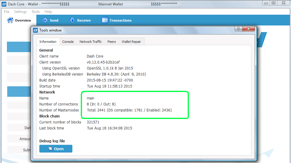

https://dashtalk.org/threads/please-update-to-v12-0-45.5912/#post-63791
Does this mean 2441 masternodes have updated to v.12?
