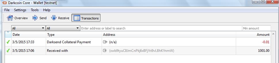

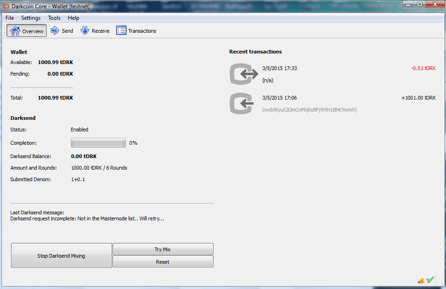

eduffield, UdjinM6, when I started the mixing, my wallet got a collateral fee but the mixing hasn't progressed. Darksend is either idle or this:
I guess we need more testers on Testnet?!
I have the same issue.
Started my wallets before more that 2 hours and they didn't progress until then (stuck at 0% after the first denom).
