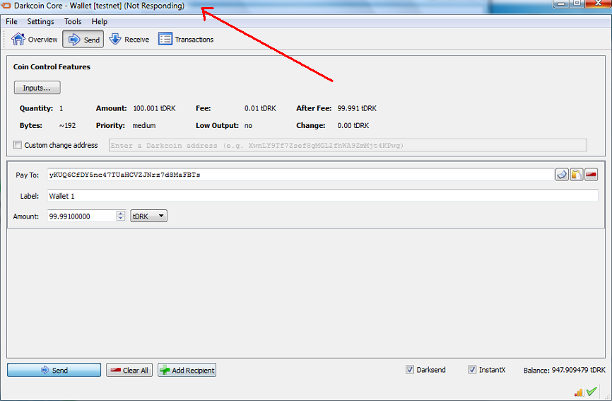

Windows v.11.1.17 - Selected 100.001 tDRK from Coin Control to Darksend/InstantX , but the wallet became unresponsive and had to be shut down.

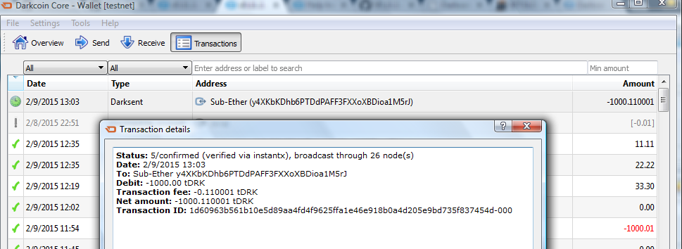

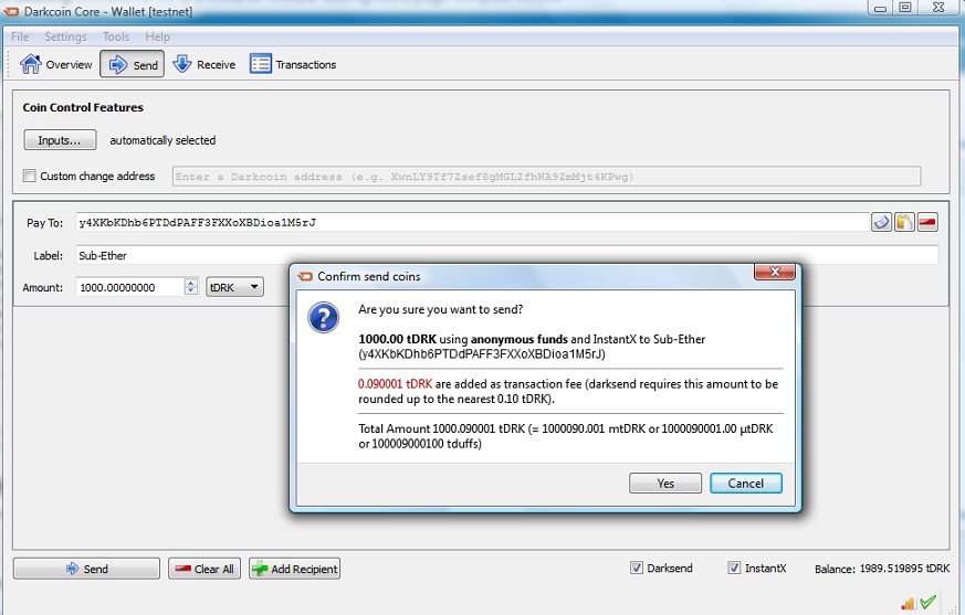

OK.. Just Darksent/InstantX 1000 tDRK, did NOT use Coin Control and it went fine:
(Edit: The wallet did not become unresponsive. )
OK.. Just Darksent 1000 tDRK, did NOT use Coin Control and it went fine:
