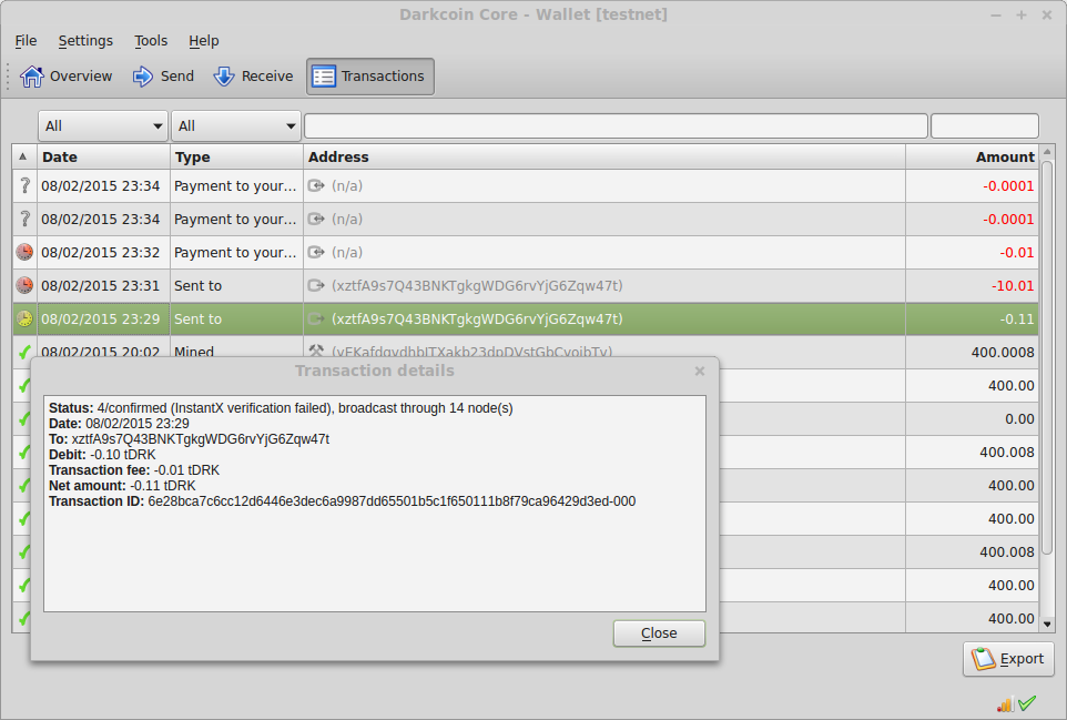

All 3 IX i've sent so far failed :/

Difference between sending and receiver wallets when using InstantX:
Sender : sending InstantX gets amount withdrawn of total and creates transaction visible in tab Transactions with its coloring icon thats colored 5/6
it still need 1 POW confirmation to get fully green confirmed.
Receiver : receiving InstantX gets amount added to receiver total instantly and shows incoming transaction that has a grey question mark,
doubleclicking that transaction shows 5 MN confirmation. After receiving 1 POW confirmation that transaction changes
from grey question mark to full green confirmation
edit : looks like the colored icon in tab Transactions indicating 5 MN's confirmations with Sender wallets doesnt work in this update
