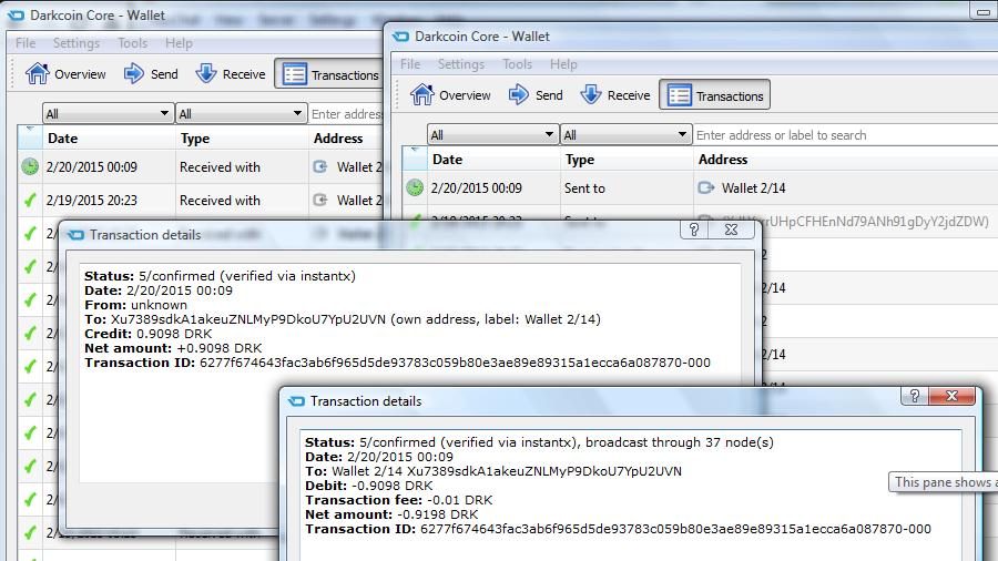

It does show immediately. You can test to see this by creating two wallets and let them run side by side on your computer, then send some DRK from one wallet to the other and you can see how it happens.So that's why, when you open the receiving wallet immediately after sending the transaction, it's not there in the transactions yet? I thought that it should show right away.
I'm talking about sending from a live wallet to a cold offline wallet, and then starting up the cold wallet immediately after. Can you try that, and see what you get?It does show immediately. You can test to see this by creating two wallets and let them run side by side on your computer, then send some DRK from one wallet to the other and you can see how it happens.
Crowing said, "No, when you send via IX the receiver immediately gets 5 confirmations, and with the next POW block gets the transaction fully confirmed, no matter whether you close your sending wallet or not." I think she meant it doesn't matter if you send to a live or cold wallet, (but obviously we have to send from a live wallet. )I'm talking about sending from a live wallet to a cold offline wallet, and then starting up the cold wallet immediately after. Can you try that, and see what you get?
No, try it with the receiver wallet offline while you do the InstantX transaction. Wait a second, and THEN boot up the receiver wallet. What do you see then? I didn't see anything.Crowing said, "No, when you send via IX the receiver immediately gets 5 confirmations, and with the next POW block gets the transaction fully confirmed, no matter whether you close your sending wallet or not." I think she meant it doesn't matter if you send to a live or cold wallet, (but obviously we have to send from a live wallet. )
I think this issue is a bit confusing as I was confused before too. And I just ran an InstantX tx, then closed and opened the receiver's wallet, not sure if this can help you with this question but I'll put them up here in a few min.
Ok, I'll try that. Give me a few min.No, try it with the receiver wallet offline while you do the InstantX transaction. Wait a second, and THEN boot up the receiver wallet. What do you see then? I didn't see anything.
Ok I just did the test.It could just be a UI issue that will be sorted out later...

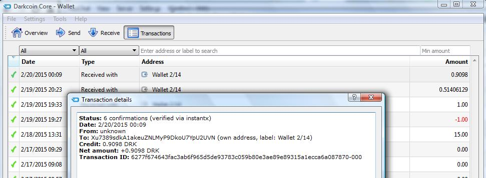

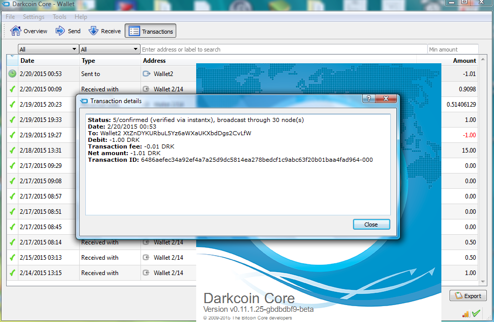

This is another InstantX transaction that I did earlier. It was a successful IX transaction with 5
I'm not sure. I learned this reset first from you during Testnet, (and thanks :smile. Then later I had another discussion with Evan and Aswan in IRC to clarify some stuff I was still confused about.You are right, its was the same in testnet, I have confirmed the same, when it says 7 transactions you must subtract by 5 to get the real number of confirmations which shows when the wallet is reset. I seem to remember Evan saying something needs to be enabled in a future version?
Thanks for clarifying. Now I know I'm not going crazy...Ok I just did the test.
You are correct that it didn't show up when I opened the receiver's wallet.
BUT.. after a few seconds it did show up.

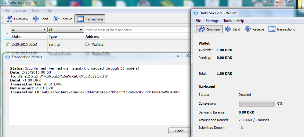

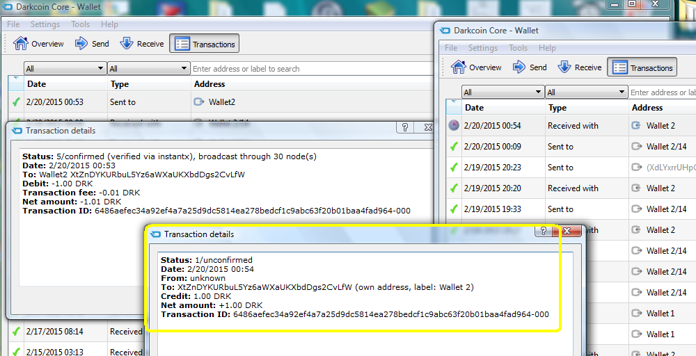

Here are some screenshots:
Sender's wallet sent 1 DRK to a cold wallet via InstantX, then I started the receiver's wallet:
At first I didn't see the 1DRK on the receiver's wallet and I was surprised, but then it showed up right after that:
Here's the transaction screens of both wallets. Notice that the receiver's wallet IX transaction (in yellow square) has fallen back into a PoW transaction, like crowning said:
