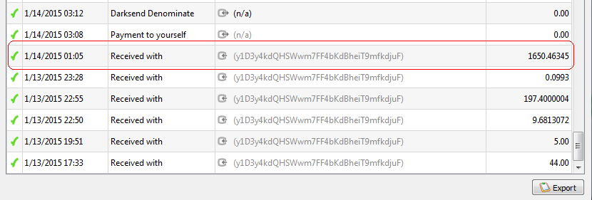

I'm going to post a few screenshots to show the results of my testing on v.11.0.5, Windows 32bit, fresh wallet, funded with about 1906 tDRK as shown in the following screenshot:
At first the smaller amount of the coins (about 255 tDRK) was split up and anonymized nicely with 9 rounds. But the larger amount 1650 would not split up until later. Then it got split up and denominated, but it seemed the denominated amounts of the 255 sum were mixed again; I noticed their "9 rounds" were gone, and it seemed each amount started back from round 1.
The wallet was left running all day, most of the coins were split up and anonymized 9 rounds, except an amount of 140.3 tDRK that has been locked and would not unlock for a while now. Then another amount of 832 tDRK became "n/a" with no Darksend Rounds... (Has it been de-anonymized and now has to start over?) It seems the mixing keeps going from one round to the next and then starting over like a Liquid Provider client.

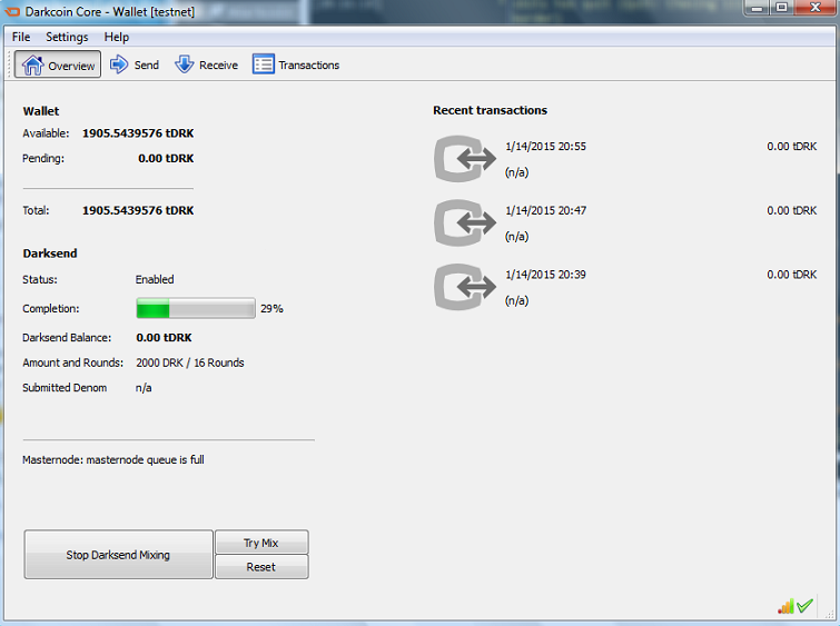

The status bar went from starting to 70%, then back to 50% or so, and now back to 29%:
My previous test on a smaller amount with 8 rounds went great and fast, but with this larger amount, something isn't going smoothly.

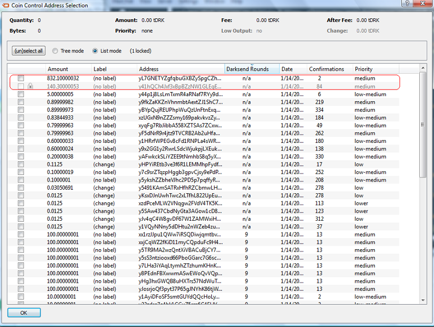

eduffield, vertoe, I have a question about change amounts.. My wallet was done, with over 7 tDRK left:
And here's the Coin Control screen.. I think 7 DRK left is pretty significant. It seems the "no label" amounts should have been added to the mixing pool and anonymized but that didn't happen so now they are change amounts. Can we get these change amounts reduced to very little? And could you address how we use these change amounts, maybe spend them first before spending the anonymized money? Thank you. :)
